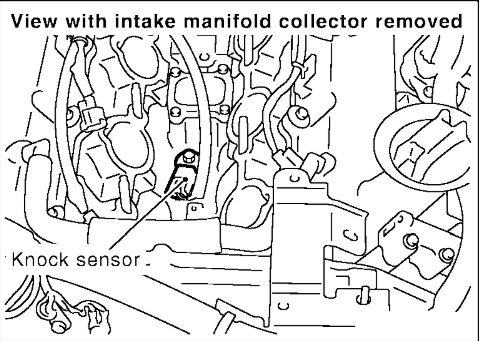

Does the car have 2 knock sensors? And where are they located?
3.5L • AUTOMATIC
PEGGY MARLIN
In the very back on the right side what is the sensor name

Hello, the engine only has 1 knock sensor which is under the engine intake manifold so it will need to be removed to be replaced. Check out the images (below). Let me know how it goes.
