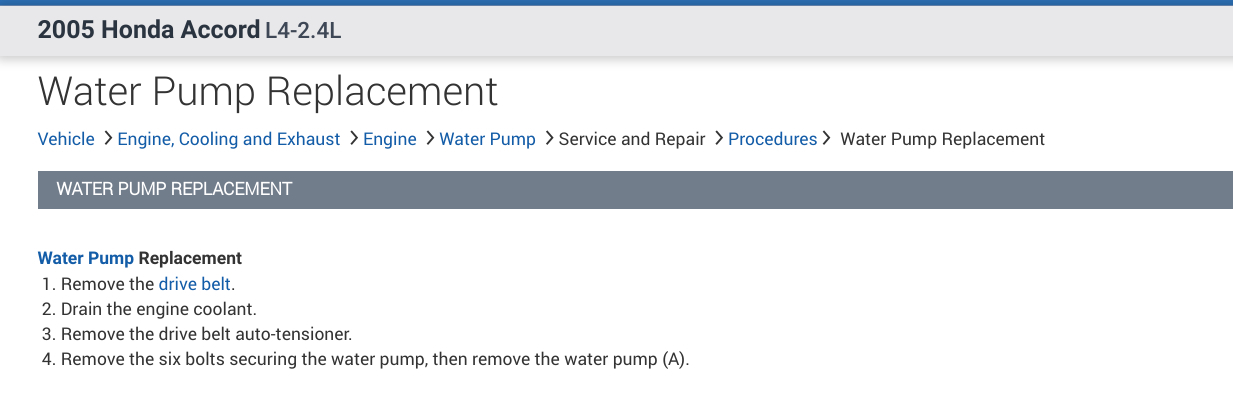

Does the 02 sensor have anything to do with the car overheating?
Dec 8, 2019 at 9:02 PM
SCGRANTURISMO
  • 4,897 POSTS

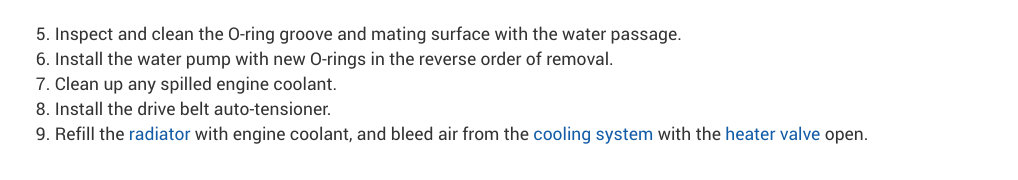

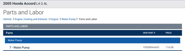

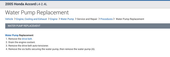

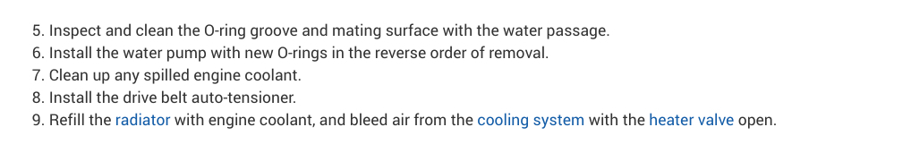

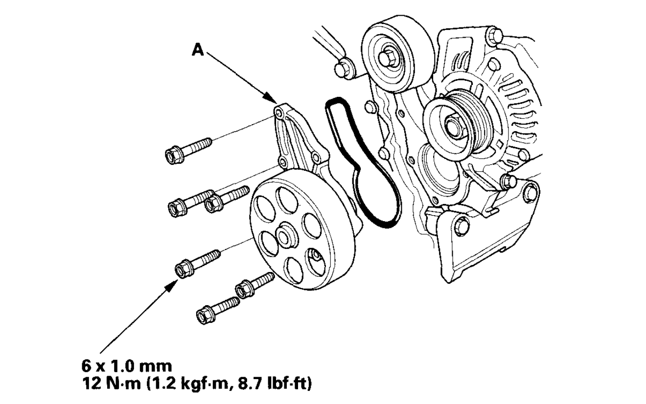

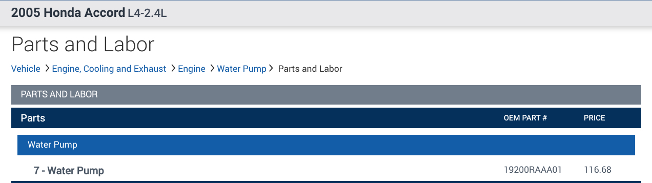

No. If you have replaced the thermostat and your vehicle is still overheating the next thing that should be changed out is the water pump. Here is a generic link explaining how to replace a water pump, for reference, down below:
https://www.2carpros.com/articles/water-pump-replacement
In the diagrams down below I have included the specific instructions for your vehicle on how to replace the water pump. Please go through these guides and get back to us with how everything turns out.
