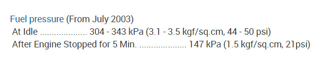

Verify your fuel pump is working correctly.
Also, do a compression test to be sure the timing is correct.
