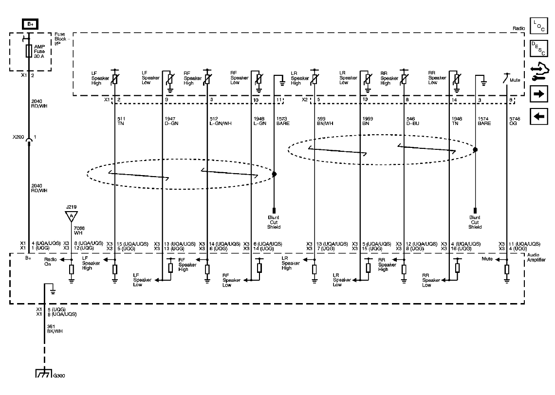

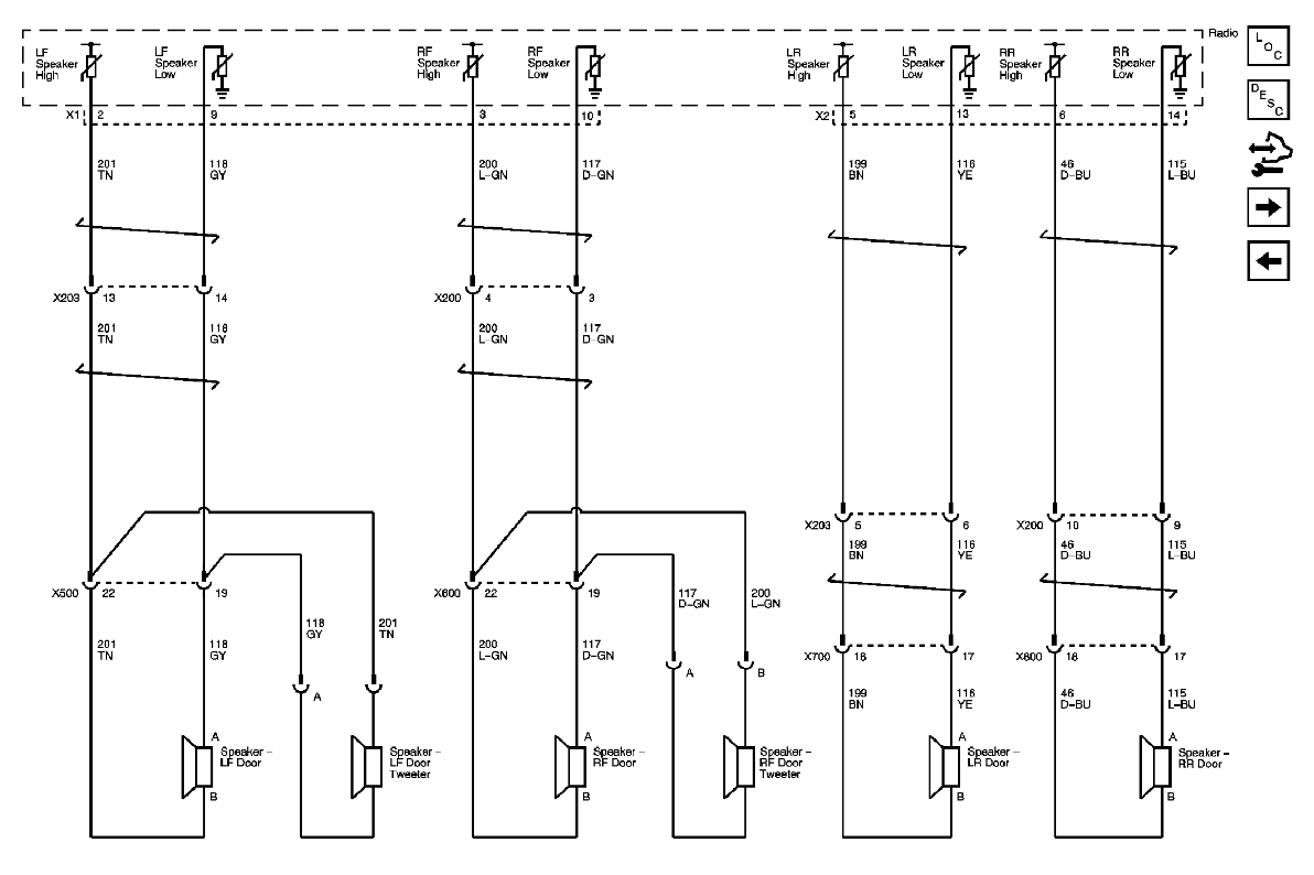

Only my two tweeter speakers in the front work, none of the others work. Does my stereo have a fuse in it and if it does where is it located?
Oct 21, 2016 at 10:59 PM
  • 55,579 POSTS
Hello, DERECKL
It sounds like the amp may have gone out or you have a 30 amp fuse that is blown, please check it out and get back to me, here is some wiring diagrams to help.
