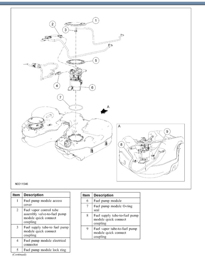

Hi my car have stalled out about two weeks ago I have diagnose the car and found nothing I've also check fuses and relays nothing ive even change the fuel pump and I also discovered that the tank have two slots for a fuel pump so wondering does this car have two fuel pumps?

No. Your vehicle only has one pump, but it is called a saddle tank, so it has a second access cover in case you need to access the other side of the tank.
If the vehicle only stalled one time, then more likely the fuel pump is starting to fail but we need to find this out by checking the pressure when this happens again.
Clearly, we don't want to guess at it but here are some guides that will help with this:
https://www.2carpros.com/articles/engine-stalls
Please see the attached info for the pump as well.
