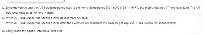

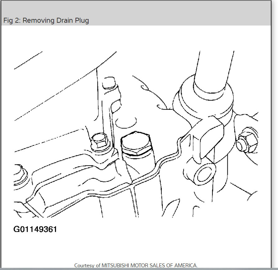

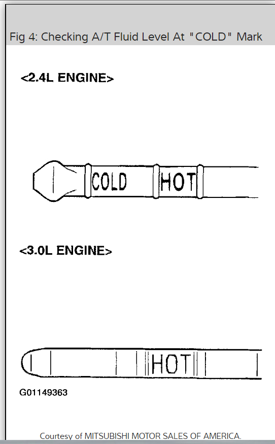

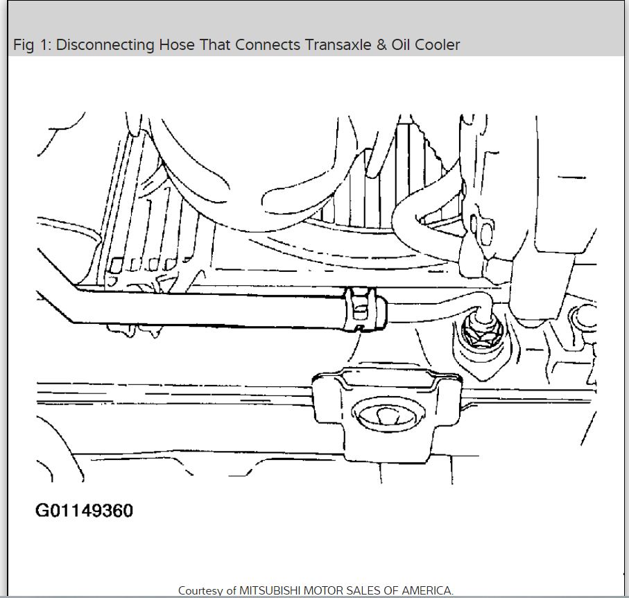

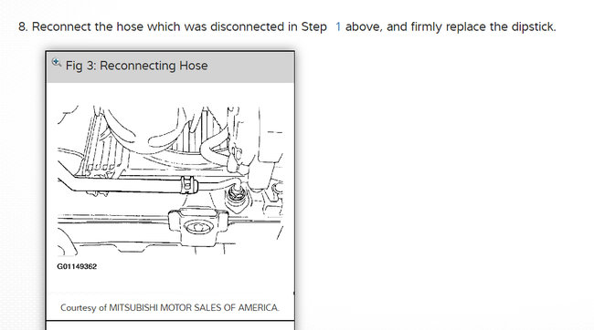

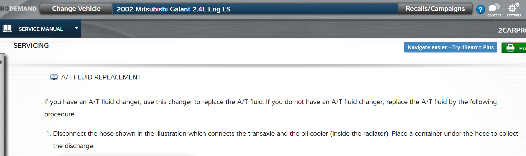

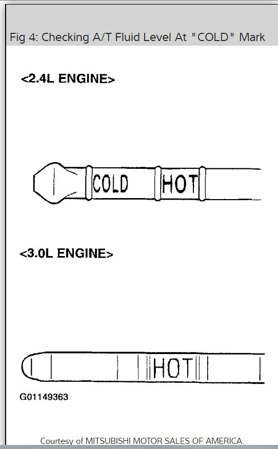

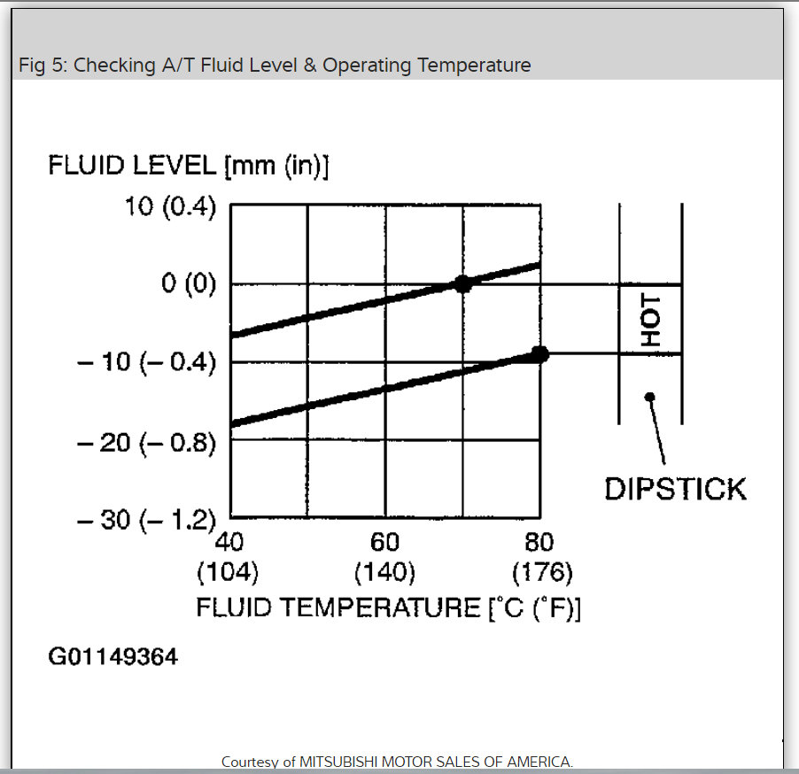

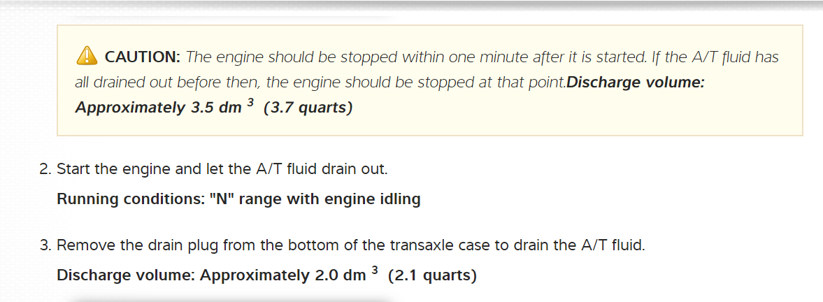

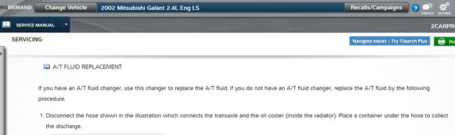

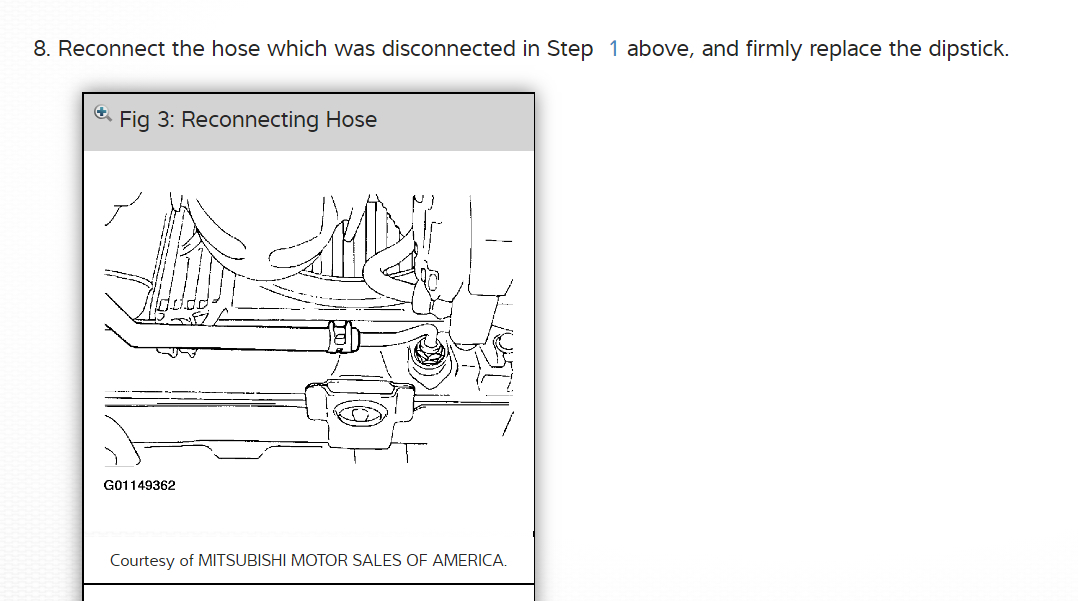

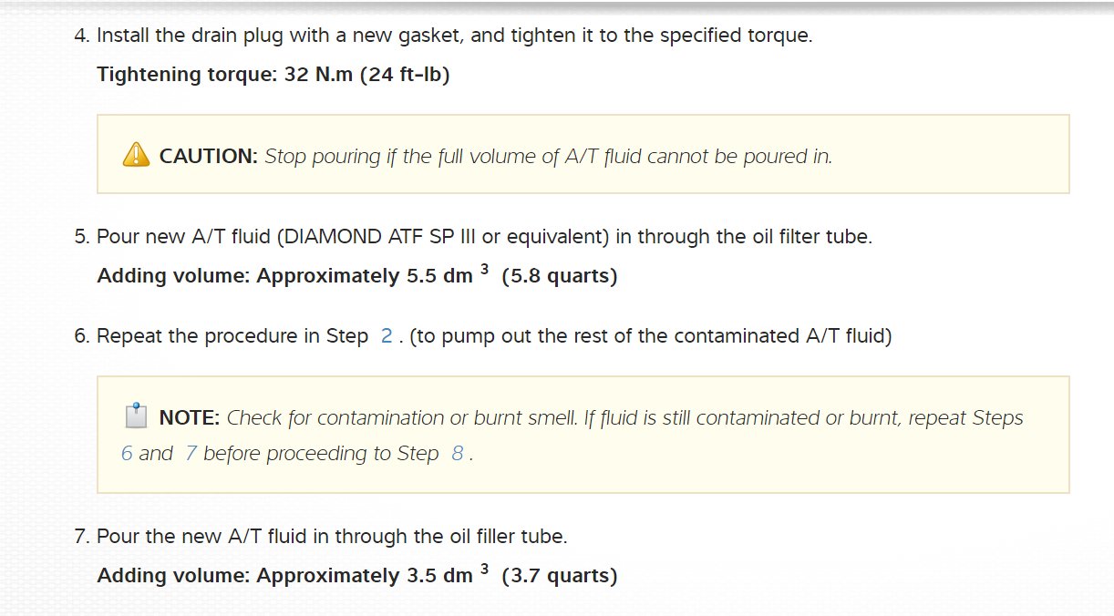

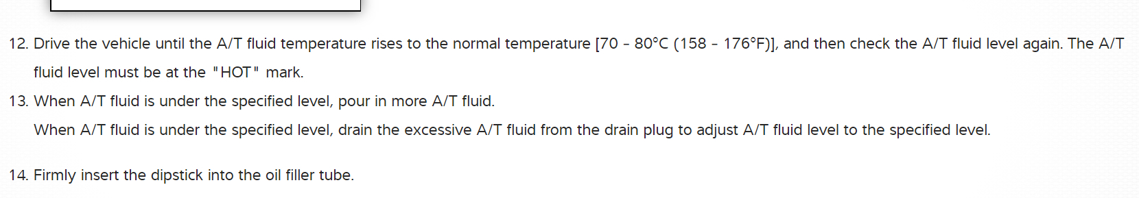

Does it have to be done by shop to change filter and fluid. It just started slipping.
Mar 22, 2019 at 11:15 AM
SCGRANTURISMO
  • 4,897 POSTS
I have included the information that you asked for in the diagrams down below. Please let us know if there is anything else that we can do for you.
