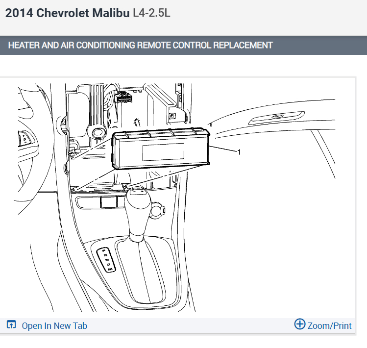

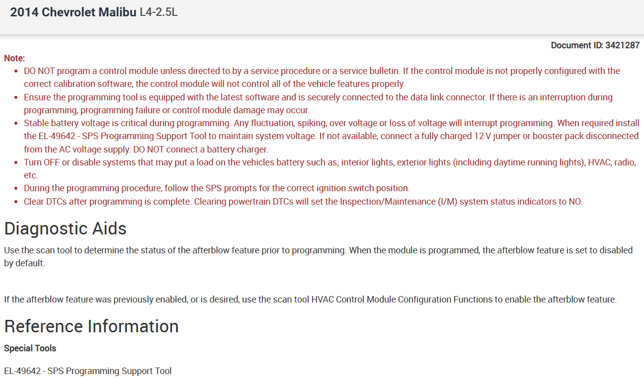

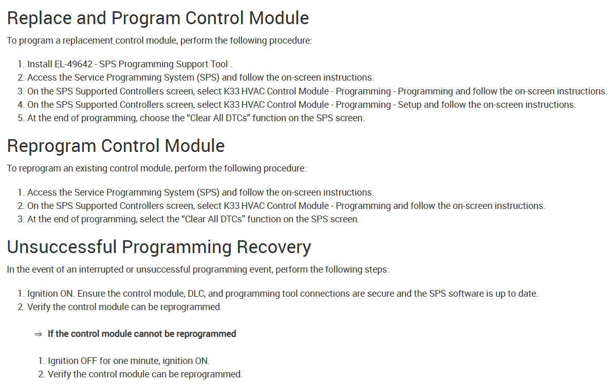

does a NEW GM 13591958 Control, Heater and A/C Remote have to be programmed?
2014 CHEVROLET MALIBU
157,000 MILES • 2.5L • 4 CYL • 2WD • AUTOMATIC
BEAST360
Even though i for a new OEM remote same PN for the car, Replaces: 13590135, 13598188, 13591649, 13591958, 13595108 the so called correct remote is GM PN13516013 bit i got the same styler remote that was in the malibu, does it need to be programmed? i don't have the software on my Autel to do it, i also got GM codes U0257 U151:00 and U152:00 and nothing lights up or worked, blower stuck on 1 speed, and in heat mode, maybe was last know setting and radio stuck on 1 station at same volume setting, U0073 code get that too after clearing all DTCs those same ones come back again.

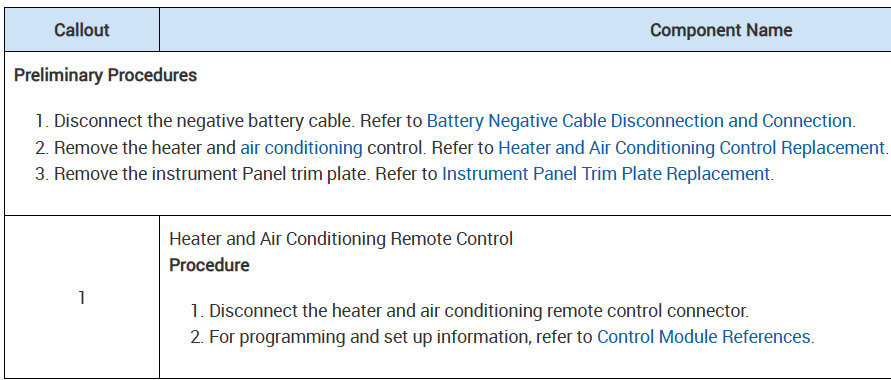

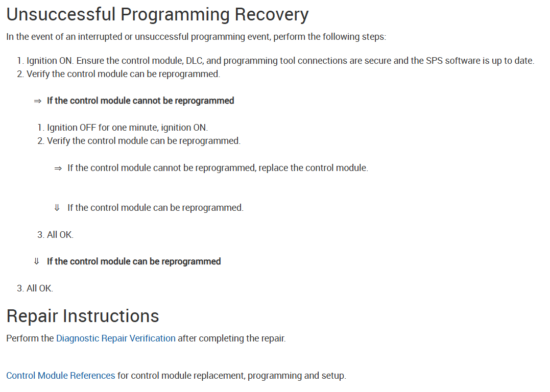

Yes, installing a new GM 13591958 Control, Heater and A/C Remote in your 2014 Chevrolet Malibu requires programming to ensure proper functionality. Please start a new question for the codes because we only handle one problem per thread. Here is the information I found on the HVAC remove replacement and programming. Check out the images (below). Please let us know what happens.

i just got the malibu programmed, but 3 codes that were there before the programming didnt go away and the tech cleared them they came back, then i cleared them they came back UO257 UO1520:00 AND UO151:00 the hvac controls didnt work radio/cd dont wotk and didnt light up along with ac/heater controls and that radio faceplate it seems to be a LIN BUS problem, he said the faceplate radio .AC heater controls are all integrated and must communicate with 1 another, whats weird is the radio works! plays very low volume on 1 station and it seems the AC/HEATER control is stuck on 1 spped in same heat setting, like the last time before i replaced the orig heater control module, Pat

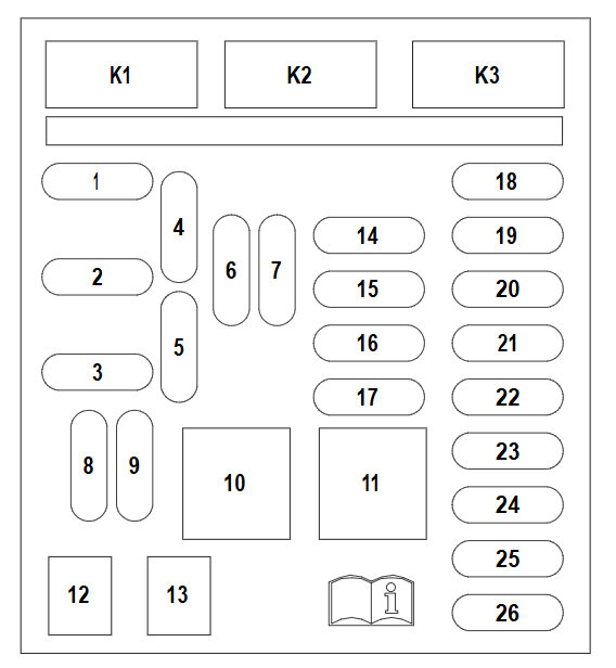

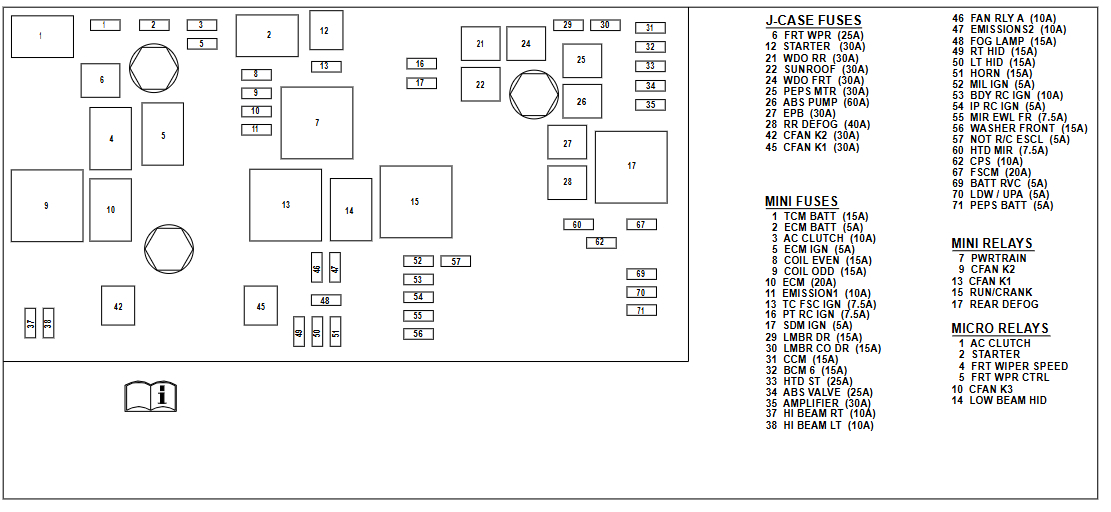

Does the car have water damage? Also, I would turn all systems on and then check the fuses for power, this guide can help

the BCM it was replaced by me in 2020 no water damage had {new one} cloned, ( from original} GM OEM unit, { GM flash a business in Missouri} there was 2 blown fuses i got it taken care, codes/DTC are gone except U1520 faceplate . radio, AC/heater controls work and light up now but stabil trak comes on u0121 is been there for years intermittent problem i was thinking . maybe Poor electrical connection in the CAN bus circuit or ABS module, no rats or mice ever chewed up things/ wires, car is still in Greenville, SC area 158k on it, had it since bought with 11k so no rust or corrosion /salt not a issue. this is a weird problem maybe power assist steering control module? or harness or wiring? that module is in a crappy spot under the car, Regardless thanks for the full system boot info i am still going to do that i never had the malibu discharged / hard system reboot, maybe Battery disconnected for a few hours that's it, or when replaced in 2022. Thanks,

I am glad you found the blow fuses, I would still do the hard reboot to see if that helps reset things. It could be a bad connection as well, you can try unplugging modules to look for corrosion.
