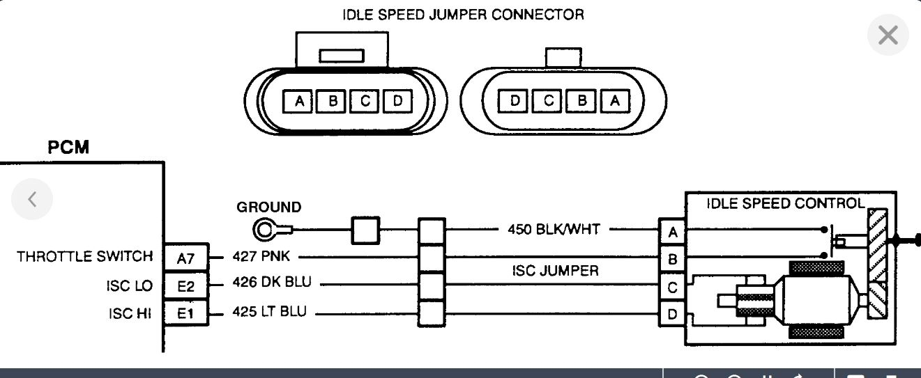

Does this car have a Idle air control valve or an Idle Air (speed) control motor
1993 CADILLAC DEVILLE
100,000 MILES • 4.9L • V8
DEVILLE MAN 93
  • 13 POSTS

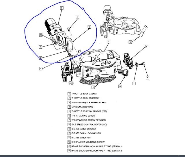

I’ve been reading on the internet that if my car is pulling a E30 and has lower gas mileage. that I could replace the ISC motor and that would help, but when looking the part up, It brings me to IAC valves instead. I’m just hoping someone could shed light on which one to get and if they could show me where it these parts are located within the car. Thanks!
Jan 30, 2020 at 12:28 AM

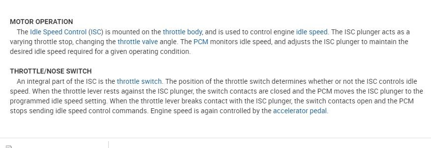

Good morning,
There is an external idle speed controls on the early models. There is no valves as the later units have.
I attached pictures for you and a description.
Jan 30, 2020 at 3:30 AM
