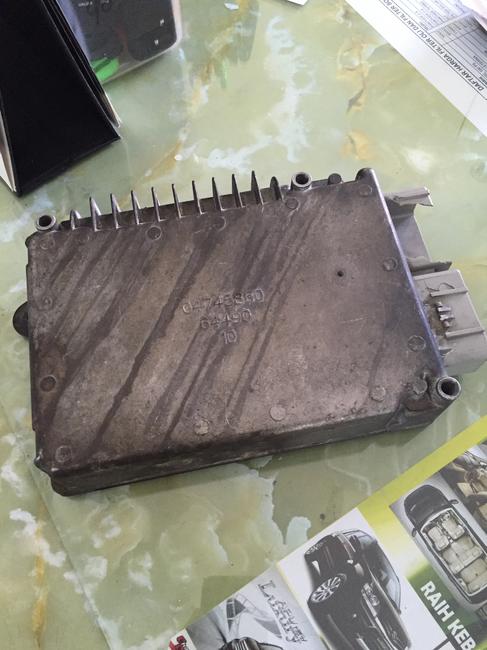

Hi, I am Daniel in Indonesia. I just bought used Dodge Grand Voyager (year 2000) 3.3L and it seems it has problems with its ECU. Is it possible to replace the ecu with used one whch i planned to buy at ebay? is there any problem with difference in S/N??

these are vin specific if you get another you need a pro with a scanner to program it to your car otherwise it won't run
