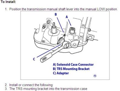

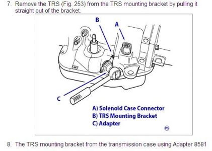

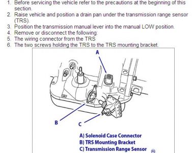

The answer to my question "Back-up lights do not turn on when the gear is in reverse" was "suspect faulty back-up light switch located at rear of transaxle". Do you have instructions and/or diagram for replacing the back-up light switch?

https://www.2carpros.com/forum/automotive_pictures/170934_03_dodge_tranny_range_sensor_1_1.jpg
https://www.2carpros.com/forum/automotive_pictures/170934_03_tranny_range_sensor_2_1.jpg
https://www.2carpros.com/forum/automotive_pictures/170934_03_tranny_range_sensor_3_1.jpg
