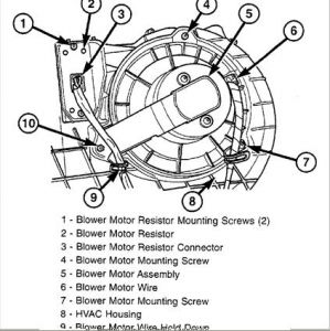

I'm wondering where the resistor for the heater/AC fan motor is located. The 4-speed fan runs only on high.

Welcome to the forum, the picture is B1500 van.
