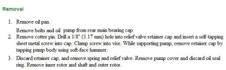

need to know what all has to be done to change oil pump it is a passenger van

https://images.2carpros.com/forum/automotive_pictures/261618_Noname_1916.jpg
