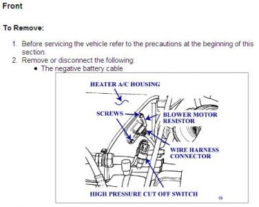

2000 Dodge Van V8 Two Wheel Drive
need the location of resistor.My dodge manuel says it is behind glove compartment but is not there.I was told it could be in the evaporator box but cannot find.
updated 2-5-09
thats the one.The dealer sold me the wrong one so therefore I did not recognize it,looking right at it.Thanks

I think on a van it is on the evap box in engune compartment on bulkhead.

https://images.2carpros.com/forum/automotive_pictures/170934_blower_resistor_2.jpg
I came across that picture, if that is the correct model.
