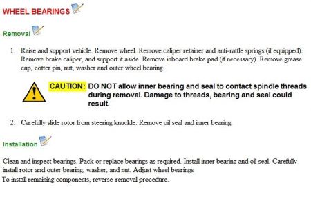

How to replace front wheel bearings

https://images.2carpros.com/forum/automotive_pictures/261618_Noname_2006.jpg
