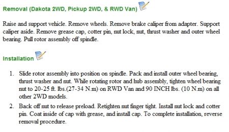

I just want to replace my front brake rotor, i'm not a certified mechanic, can you guys help me since i already bought 2 pairs of this brake rotor . thank you very much!

Raise and support vehicle. Remove wheels. Remove brake caliper from adapter. Support caliper aside. Remove grease cap, cotter pin, nut lock, nut, thrust washer and outer wheel bearing. Pull rotor assembly off spindle.
Installation:
1.Slide rotor assembly into position on spindle. Pack and install outer wheel bearing, thrust washer and nut. While rotating rotor and hub assembly, tighten wheel bearing nut to 20-25 ft. lbs.(27-34 N.m) on RWD Van and 90 INCH lbs. (10 N.m) on all other 2WD models. 2.Back off nut to release preload. Retighten nut finger tight. Install nut lock and cotter pin. Coat inside of cap with grease, and install cap. To complete installation, reverse removal procedure.
