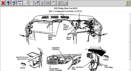

We are trying to check out all options before changing our fuel pump.
Can anyone tell me where the fuse for the fuel pump is located?

What kind of van is this? Caravan, Voyager ?????? get back with description so I can help you

It is a 93 Dodge B250 Van.

It does not have a fuse -check and test the fuel pump relay and the ASD relay.

Where would I find these?

See below
https://images.2carpros.com/forum/automotive_pictures/12900_fp_34.jpg
