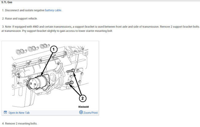

This sounds like the starter has gone bad but to be sure let's check for power at the trigger wire at the starter solenoid. This guide can show you how

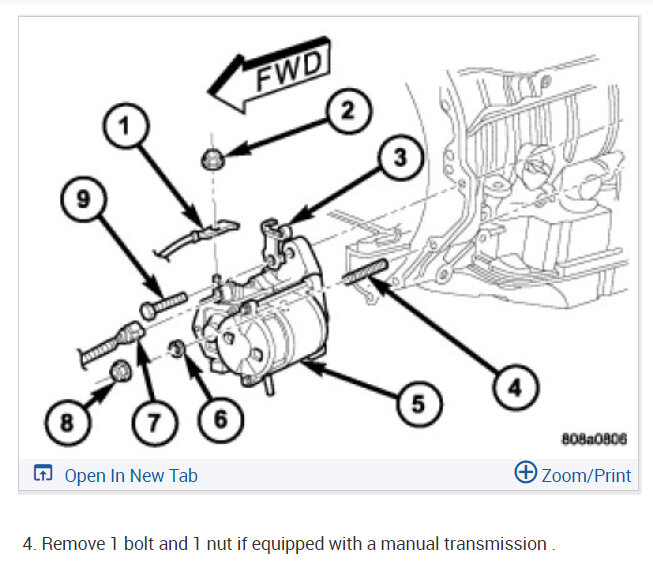

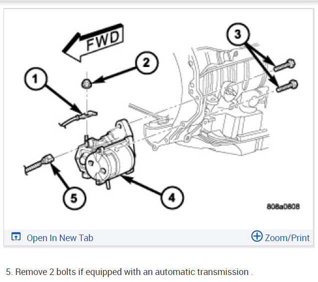

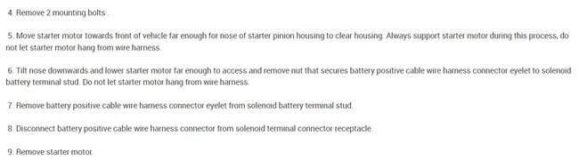

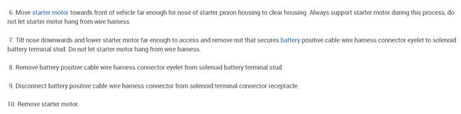

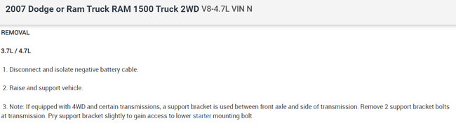

Here is how to change the starter motor out in case you need it. Also, try to crank it over in neutral this will help test the gear range sensor. Check out the images (below). Please let us know what happens.
