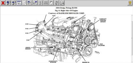

I've had my truck checked and they say my eer valve is bad and this is a problem for this model. My question is where is it and can I change it myself

Sounds like you're talking about the EGR valve solenoid see below
https://images.2carpros.com/forum/automotive_pictures/12900_egr_solenoid_1.jpg
