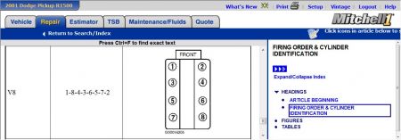

which cylinder is 1 and so on

https://images.2carpros.com/forum/automotive_pictures/12900_fo_151.jpg
