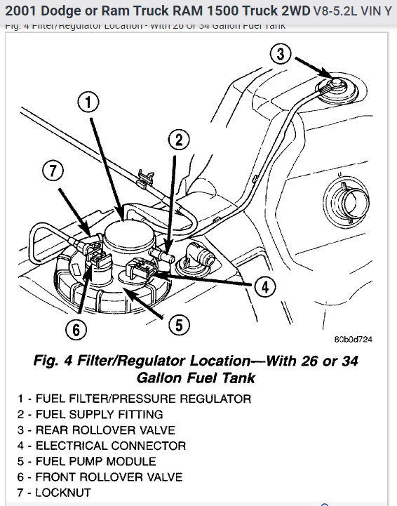

changed the fuel pump twice and it still will not run
2000 DODGE TRUCK
100,000 MILES • V8 • 2WD • AUTOMATIC
TFRANKLIN

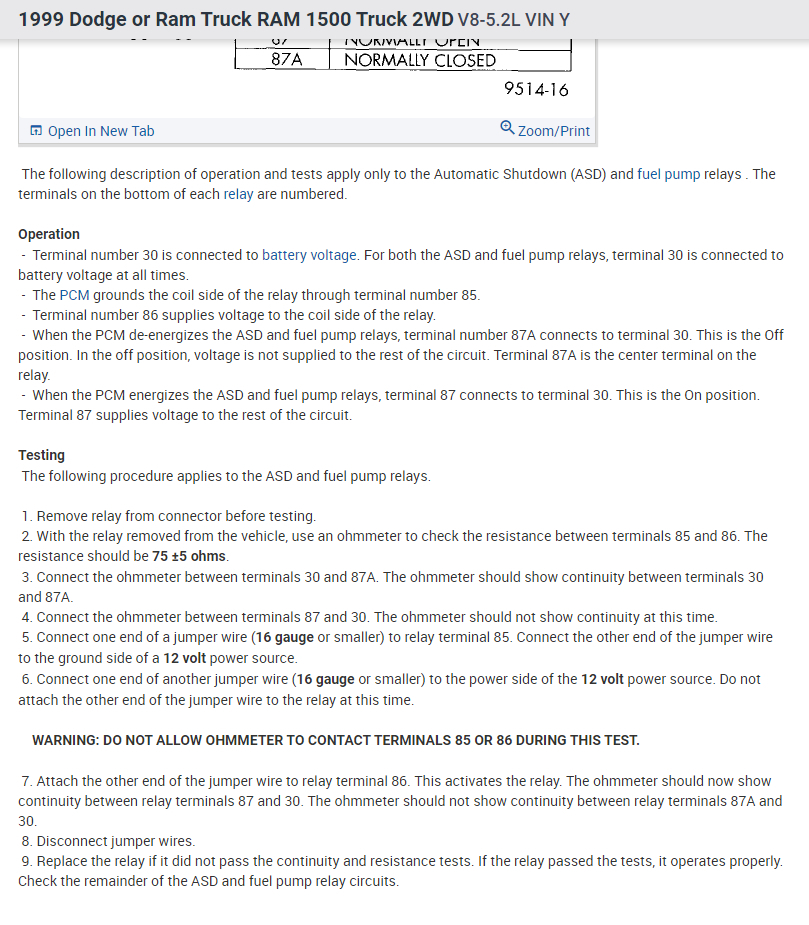

I have changed the fuel pump twice and it still will not run. What else could be the problem

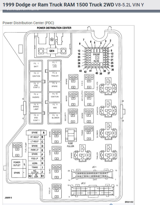

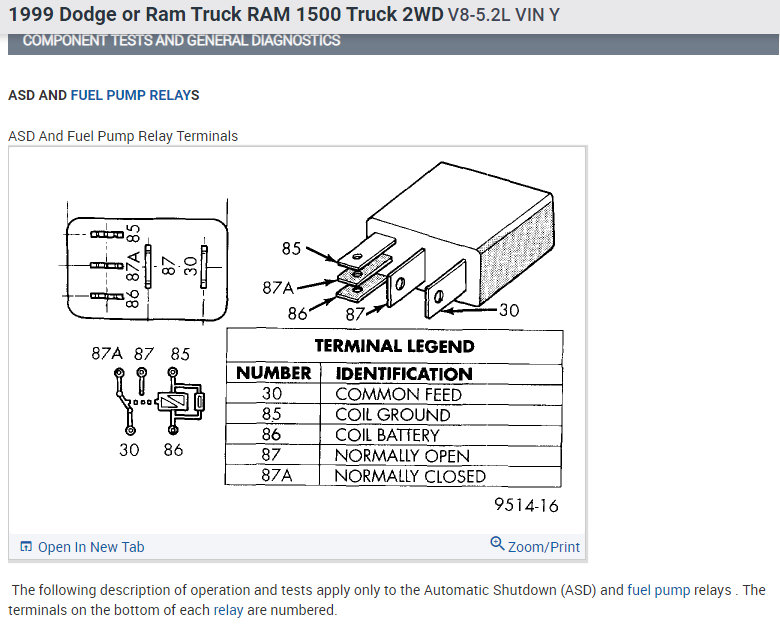

When you turn the key on, does the fuel pump come on?

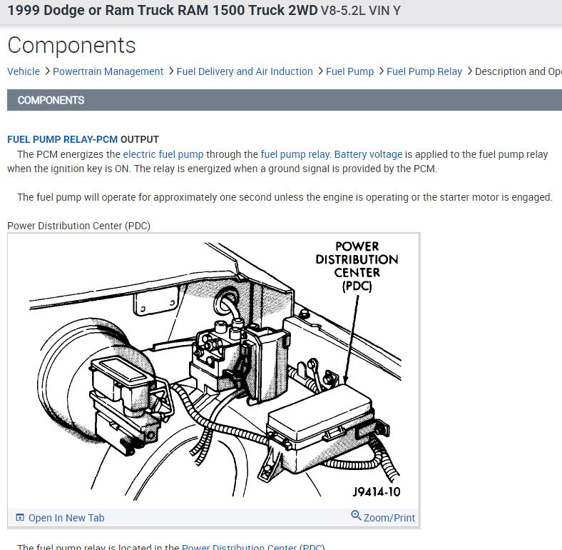

If the pump does not come on, then it could be a bad relay or faulty wiring.
First check the relay, it is located in the under-hood fuse box (see diagram below).

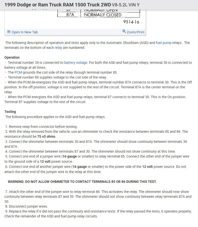

Here is a guide of how to test the relay:
If the relay is good, then check to see if there is power to the fuel pump harness. Having no power to the connector means there is a short in that circuit.

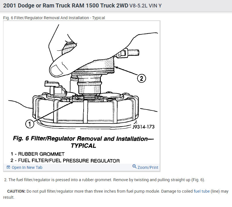

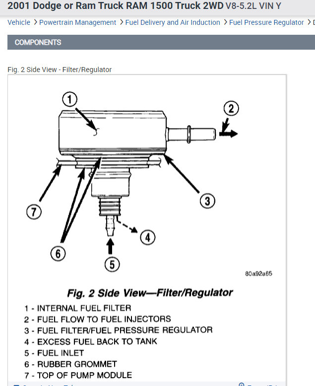

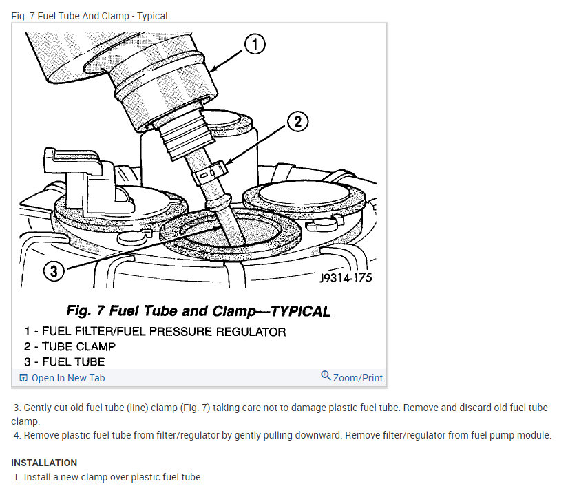

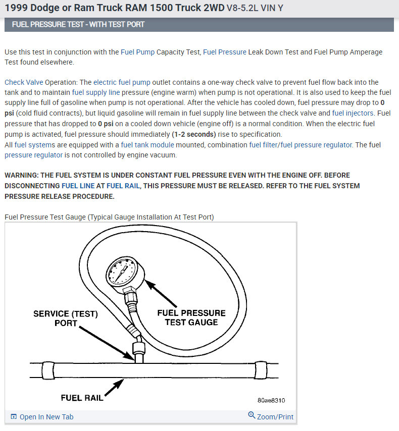

If the fuel pump comes on but you are not getting any fuel to the injectors it could be due to a restriction in the fuel line, clogged fuel filter or a bad fuel pressure regulator.
