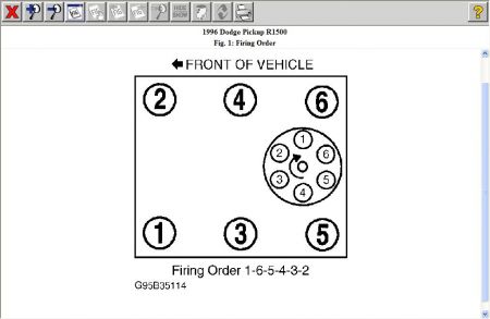

Need to know firing order for distributor cap
Oct 10, 2020 at 2:51 AM (Merged)
  • 75,992 POSTS
https://images.2carpros.com/forum/automotive_pictures/12900_fo_31.jpg

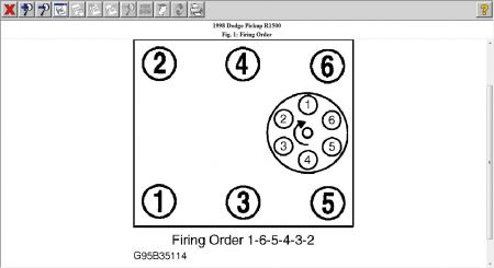

ROBERTB357
Electrical problem
1996 Dodge Truck 6 cyl Two Wheel Drive Automatic
What is the firing order for 1996 Dodge Ram 1500 V6
  • 75,992 POSTS
See below
https://images.2carpros.com/forum/automotive_pictures/12900_39_1.jpg
  • 75,992 POSTS
See below

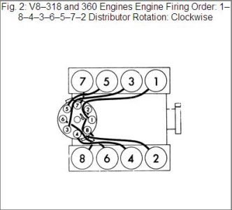

CAROL SIMPSON
Engine Mechanical problem
1984 Dodge Truck V8 Two Wheel Drive Automatic
WHAT IS THE CORRECT FIRING ORDER FOR A 360 CU IN ENGINE
Oct 10, 2020 at 2:52 AM (Merged)
JDL
  • 16,098 POSTS
Welcome to the forum. My info showed this.
https://images.2carpros.com/forum/automotive_pictures/170934_360_firing_order_1.jpg
