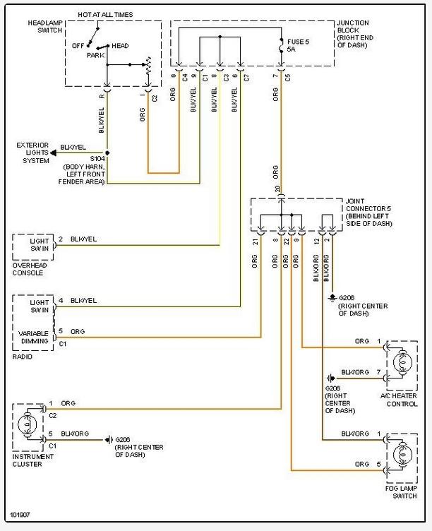

no lights in cluster,headlight pull switch will turn everything on except cluster lights,when starting engine all warning light comes on and go off after the is running as they should,can't see gages at night

is the dash dimmer turned down?
Dec 9, 2008 at 8:07 PM
THEWAVE
  • 5 POSTS
yes ,i tried rotating pull switch,put in new switch and tried another cluster, still no lights inside the cluster

[quote:7467b7d7b4="thewave"],put in new switch and tried another cluster[/quote:7467b7d7b4]
wow, you must have a parts car somewhere.
OK, now don't throw anything at me, I'm trying to be helpful.
Did you check the fuses, not just by looking at it, but with a meter or test light?
They can sometimes crack and you cant see that with the naked eye.
Dec 9, 2008 at 8:57 PM
THEWAVE
  • 5 POSTS
checked all fuses,there are two,cluster A,cluster B,both good,replaced both anyway

do the lights in your radio and heater controls respond like they should?
Dec 11, 2008 at 3:04 PM
THEWAVE
  • 5 POSTS
yes,heater control and radio light are fine

I'm sorry to miss leave you ,but the lights in the heater head are not working.(SORRY)

This diagram suggest that there is a 5 amp fuse in a junction block on the passenger side of the dash. Check that.
Or at least check that you have power at the Orange wire.
Dec 14, 2008 at 4:23 PM
  • 54,840 POSTS
If the lights in the heater head work, then the dash lights should work.
Check for power at pin-1, connector-2 Orange
Check for ground at pin-5, connector-1 Black/Orange
If those check out, then it has to be something in the cluster.
