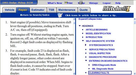

Getting conflicting advise about code readers. Some say no reader avabile have to turn key on and off a few time . Any one know how to go about getting codes out of this ?
Is there a code reader for this year of Truck?
Thanks for all your help.

Do the key method-code reader they should have one-it takes a DRB2 to extract the code/s. Do below you'll be fine.
https://images.2carpros.com/forum/automotive_pictures/12900_code_1.jpg
