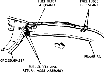

Where is the fuel filter located on my truck?

Under vehicle, driver side, below seating area, driver side of transmission, mounted on frame rail in fuel line

Fuel Filter Location
The filter is found under the vehicle along the left side frame rail.
