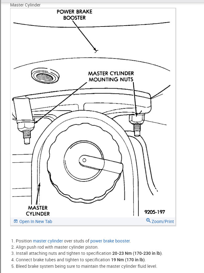

Hi I have a 1987 Dodge Dakota. I had to replace the two brake lines that run from the front to the rear. I bled the brake and fluid comes out with no air. I can`t get a good brake now. The peddle is almost to the floor. I also replaced the rear wheel cylinders and brake shoes. I think this model has a control valve and the height sensing proportioning valve. I am not sure about how they work. I would appreciate any help you could give me.
Thanks
Jun 30, 2008 at 8:38 AM
If you are bleeding the brakes and have solid fluid, then we need to suspect the master is the issue.
However, let's start with this guide on this issue:
https://www.2carpros.com/articles/brake-pedal-goes-to-the-floor
Once we run through this the best way to go through this is to remove all lines from the master and cap the ports. Then you should have a hard pedal. If you do not, then the master is the issue.
If you do, then starting adding lines back on one at a time until the pedal is soft again. That will tell us where to start looking for the issue.
https://www.2carpros.com/articles/how-to-replace-a-brake-master-cylinder
The only way this is going to go to the floor is because of air in the lines or there is a leak allowing pressure to escape.
So, let's start running through this and let me know what questions you have.
