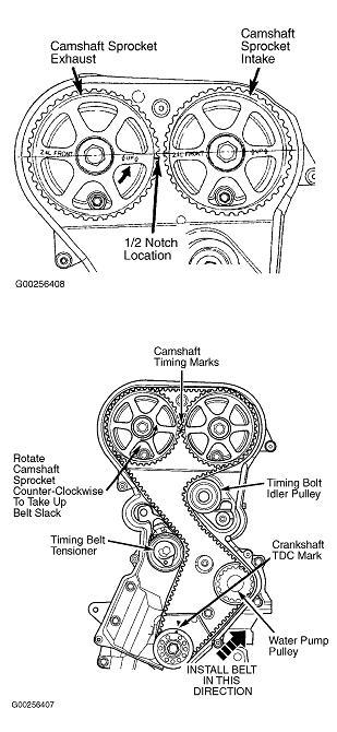

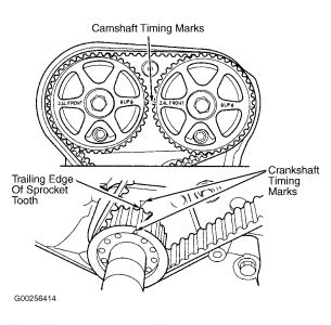

HOLLAND HILSCHER
I need to find out what the real timing marks are on the dual over head cams and the crankshaft timing marks.
Oct 29, 2019 at 11:26 AM (Merged)
BLUELIGHTNIN6
  • 16,542 POSTS
what is the 8th digit of your VIN?
HOLLAND HILSCHER
the letter you need is a x
BLUELIGHTNIN6
  • 16,542 POSTS
https://images.2carpros.com/forum/automotive_pictures/261618_Graphic_673.jpg
HOLLAND HILSCHER
thank you for your help.

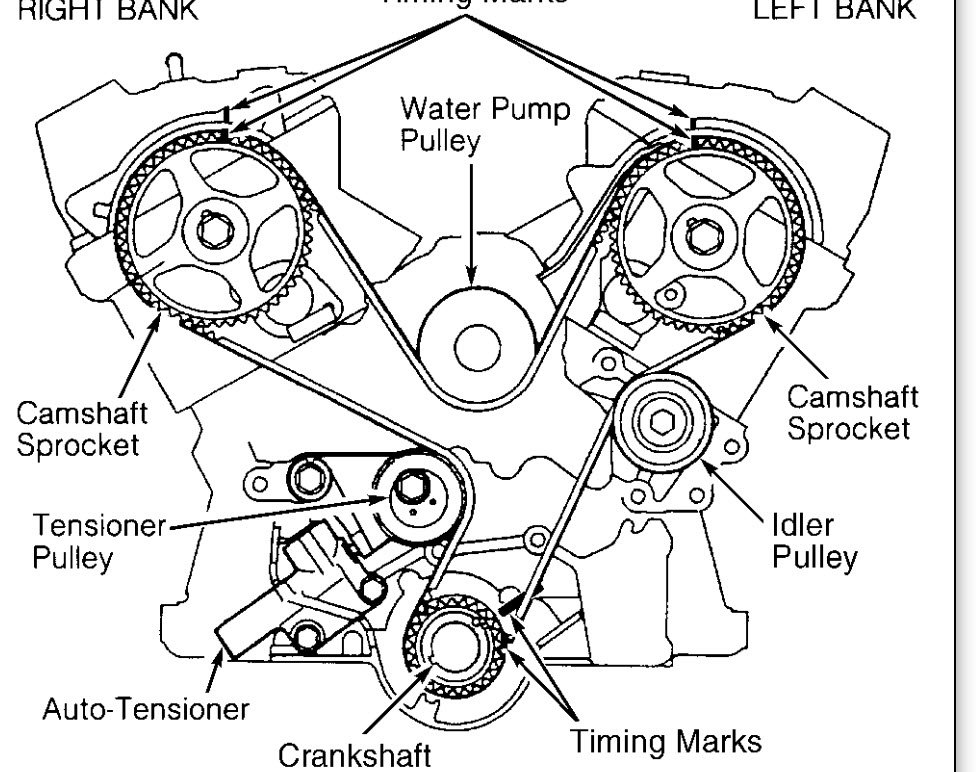

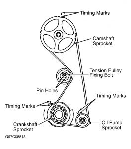

BTTYBEAL
I need to know how to set the timing belt on this car.
MHPAUTOS
  • 31,937 POSTS
Hi there, Engine timing belt set up as per pic. Mark (mhpautos)

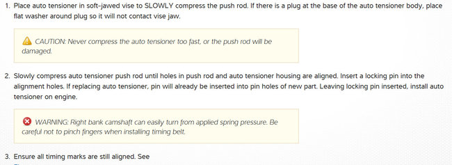

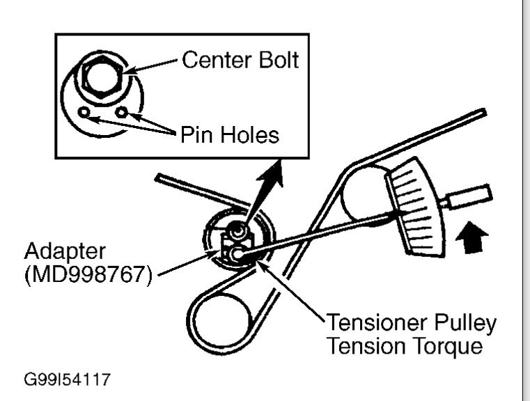

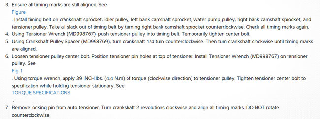

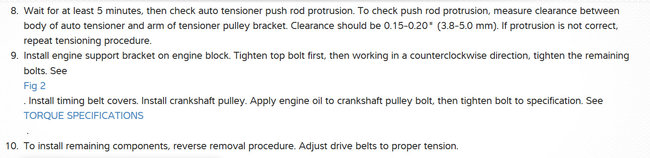

ALLEN HUCKABEE
I am in the process of aligning the camshafts to install a new timing belt, but I cannot get the rear camshaft (number one cylinder) timing mark to align properly. When I turn the camshaft, to pops by the mark and is about nine teeth off (see arrow in attached image).
Any suggestions?

HMAC300
  • 48,601 POSTS

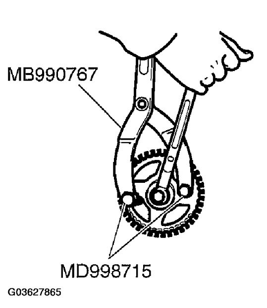

once you get cam in place you may need to lock it down so it does not move. also, this is an interference engine so do not turn engine over while belt off. See special tool picture.

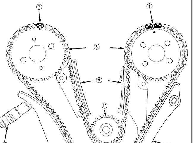

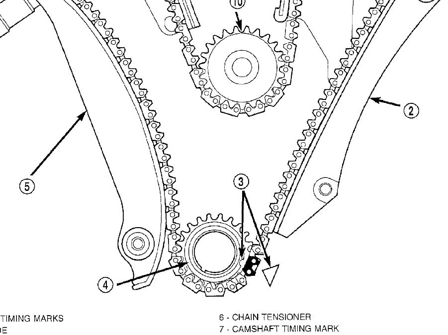

When you have the gold links on the chain lined up with the mark on the oil pump housing and the mark on the crank and the the gold link, and on the right bank the single gold one lined up with the round circle , and the left lined up with the arrow in between the two gold ones. Is that when on the cams you suppose to see the timing marks the dots and the 12 pins with the piston at TDC on the exhaust stroke?
Oct 29, 2019 at 11:29 AM (Merged)
HMAC300
  • 48,601 POSTS
see pictures for diagram left hand side must be done first then force oil from tensioner and lube chain with engine oil prior to install. also either rent a manual from here or buy one so you do not install it wrong it is a lengthy process.
