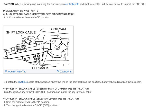

I parked my stratus in the driveway today and tonight it won't come out of park. It's like the button on the gear shift won't release so you can pull back on the shifter?
Dec 3, 2009 at 7:53 PM
  • 75,992 POSTS

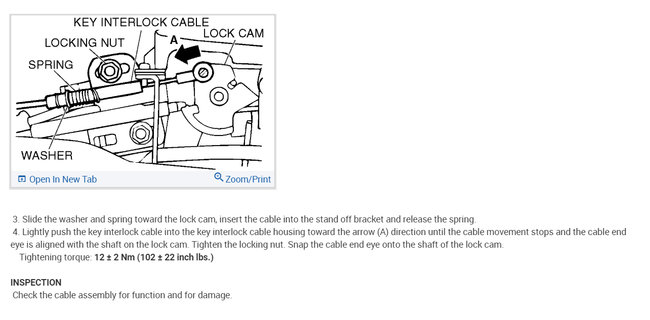

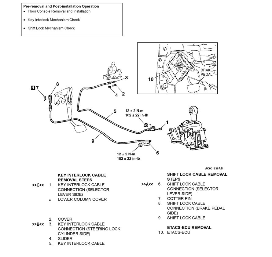

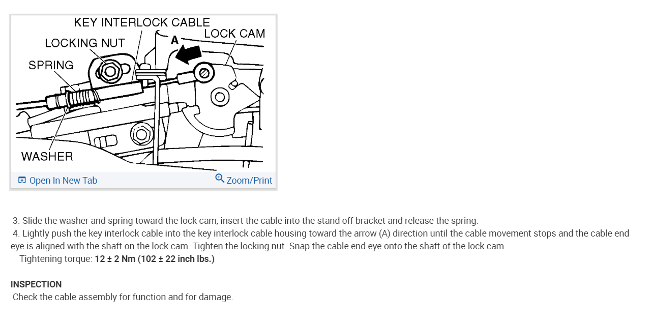

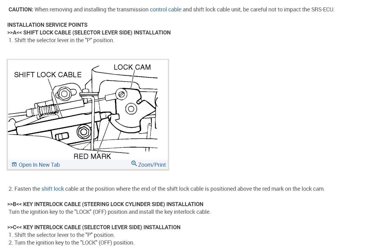

You have a problem with the shift interlock control system either the cable broke are the adjustment is off here are instructions in the diagrams below to help you fix the problem. Check out the diagrams (Below). Please let us know what you find. We are interested to see what it is.
Dec 4, 2009 at 6:05 AM
OIDAVEY
  • 0 POST
Thank you for this post I had this problem and had to get a new interlock cable cost me $78.00 all fixed! I love this site.
