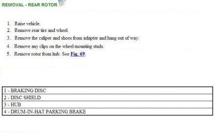

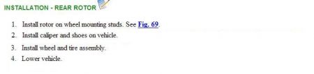

How do I remove the rear rotors?
Sep 13, 2009 at 4:19 PM
BLUELIGHTNIN6
  • 16,542 POSTS
https://images.2carpros.com/forum/automotive_pictures/261618_Noname_951.jpg
https://images.2carpros.com/forum/automotive_pictures/261618_Noname2_259.jpg

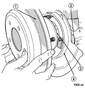

FIG. 69
https://images.2carpros.com/forum/automotive_pictures/261618_69_1.jpg
