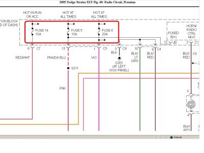

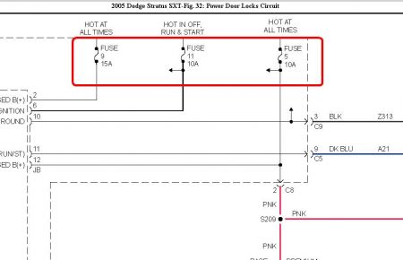

IF THE RADIO AND DOOR LOCKS ARE NOT WORKING IS IT A RELAY SWITCH AND IS IT VERY EXPENSIVE

https://images.2carpros.com/forum/automotive_pictures/55316_05stratpdl_1.jpg
https://images.2carpros.com/forum/automotive_pictures/55316_05startradio_1.jpg
The common item for both circuit is fuse #5. So check that fuse.
