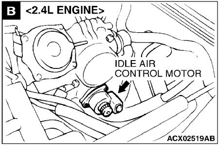

2005 Dodge Stratus car wants to turn off when stopped at a
2005 DODGE STRATUS
LMLP
Engine Performance problem
2005 Dodge Stratus 4 cyl Automatic 75500 miles
mechanics said that it was the spark plugs and a cable, those things were replaced but it still doing the same thing, is even worse when ac is turned on

https://images.2carpros.com/forum/automotive_pictures/62217_statiac_2.jpg
You may have a vacuum leak, get a can of spray throttle body cleaner, spray the vac lines and maniflod area, when the idle changes, youve found the leak! You want the engine running and spray on the outside but do direct the stream onto the hoses, if it is a vacuum leak, the engine idle will change speed, then you have detected a leak, repair the vacuum leak and see how it runs! If that doesnt do it, you may need a new idle air control valve, it's bolted to the throttlebody.
