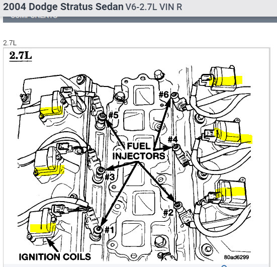

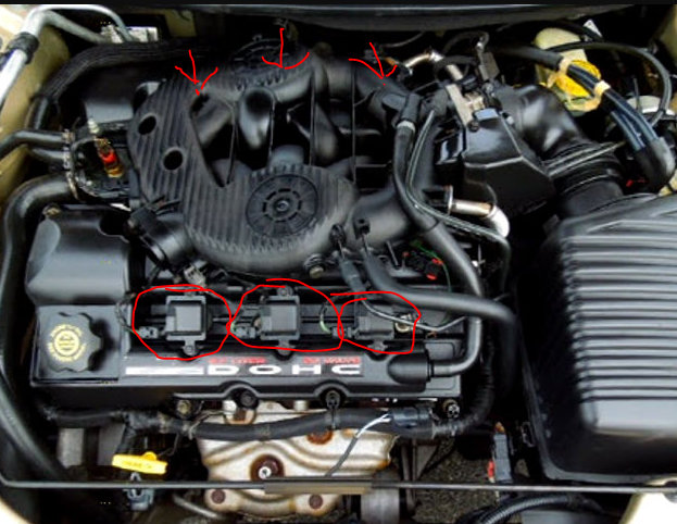

Where do they go and how to replace need a diagram
Friday, August 1st, 2008 AT 9:23 PM
SQM
  • 6,383 POSTS
You can access the spark plugs by first removing the ignition coils that are located on the top of each cylinder head (see diagram below).
Here is a helpful video showing how to change the spark plugs:
https://youtu.be/mil7i5SP064
https://www.2carpros.com/articles/how-to-change-spark-plugs
Note: These spark plugs need to be torqued at 13 ft. lbs.
