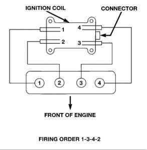

What is the order/sequence/numbering of the Spark Plugs going from the left of the Engine?
