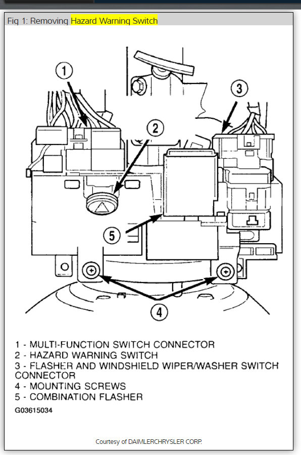

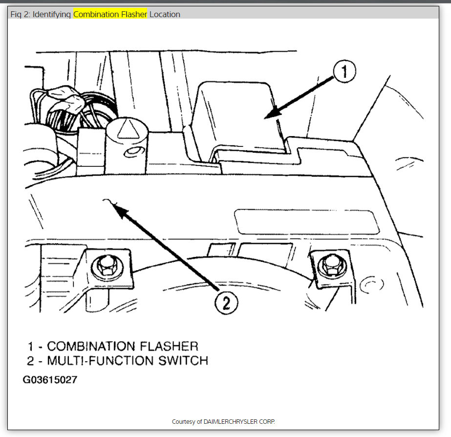

I have no turn signals or flashers. I know there are 2 fuse boxes the fuse for signals looks alright but unsure where the flasher fuse is at? or is it something else?
Apr 13, 2009 at 9:21 AM
  • 55,423 POSTS
The turn signal flasher and the hazard warning flasher are combined into one unit called a combination flasher. The hazard warning switch push button protrudes from the top of the steering column (Fig 1 ). The hazard warning switch push button is identified with a double triangle, which is the international control symbol for hazard warning.
The turn signal flasher and hazard flasher are combined into one unit called a combination flasher (comb-flasher). It is mounted to the back side of the multi-function switch, shown below.
See the diagram (below)
