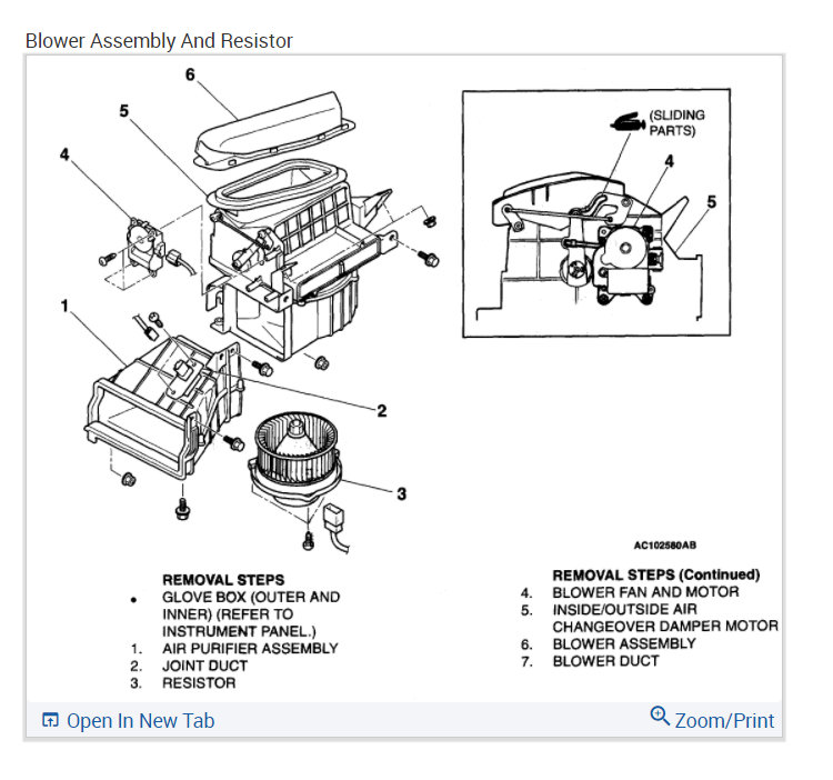

my heater at one point would only work on high, i was lazy and didnt replace the blower motor resistor. Now the heater will not work at all and i was wondering if i possibly did more harm to the unit?

No, you shouldn't have harmed anything else. It sounds like the blower motor went out here is the location for the blower motor and resistor so you can replace them to get the system working again this guide can help as well.
https://www.2carpros.com/articles/blower-fan-motor-works-on-high-speed-only

the blower doesn't work at all on any of the 4 settings, i checked the coolant i know the heat still works it just isn't getting blown out and I already checked the fuse too, any other ideas?

Then replace your blower motor, AFTER you check your junction block (left side of dash) fuse #1 30A and #11 10A for 4-door, or fuse #6 30A, #20 7.5A and blower relay for 2-door.

my heat in my car wont work it did before but now it wont work you turn the **** to turn it on and you can hear the switch kick on but the fan wont come on and blow out heat i have replace the fan motor but still wont work what could be the problem?
Oct 27, 2020 at 3:33 AM (Merged)
  • 110,248 POSTS
Check the fan relay and blower motor resister. Also, check to make sure there is power to the new motor. Check to make sure there is a good ground to the motor.
