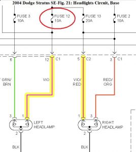

WHEN I PUT MY LOW BEAMS ON. MY RIGHT SIDE DOES NOT WORK BUT MY LEFT SIDE DOES AND HIGH BEAMS WORK ON BOTH SIDES . I HAVE REPLACED THE BULB ALREADY AND THAT IS NOT THE PROBLEM WHt could be my problem ?

Check fuse #12 inside the fuse box at the end of the driver side dash.
https://images.2carpros.com/forum/automotive_pictures/55316_04stratusheadlamp_1.jpg
