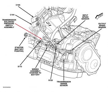

Thank you so much, BMRFIXIT!! It turned out that i didn't need to replace the whole capliers all i needed to do was change the rotors and get new brake pads. But i do have another question and this time its about a Transmission leak. they said that it was in the transmission selnoid pack,(I CAN SEE WHERE IT IS LEAKING) and that it would cost me $450.00 to replace and labor. but when i went to go get a second opinoion about it he said that he can just reseal the leak and service the transmission for $150.00 Is it possible for someone to just reseal the leak? or would it be a better idea to just replace the whole thing and have my dad do the work?????????
Apr 22, 2008 at 3:04 AM
BMRFIXIT
  • 19,053 POSTS
check cooler line for leak too do you have any problem with tranny shifting if no issue just fix the leak
https://images.2carpros.com/forum/automotive_pictures/99387_inter_1.jpg
Apr 22, 2008 at 5:57 AM
CHEY_HARRIS06
No, it still runs like it did before, when i first bought the car which was in Nov. 2007! so i guess i will have my dad look at the cooler line to make sure that there is no leaks also. i will keep you updated after i get the leak fixed. thank you again!!!!
