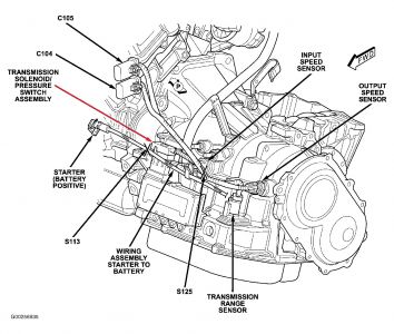

Thank you so much, BMRFIXIT!! It turned out that i didn't need to replace the whole capliers all i needed to do was change the rotors and get new brake pads. But i do have another question and this time its about a Transmission leak. they said that it was in the transmission selnoid pack,(I CAN SEE WHERE IT IS LEAKING) and that it would cost me $450.00 to replace and labor. but when i went to go get a second opinoion about it he said that he can just reseal the leak and service the transmission for $150.00 Is it possible for someone to just reseal the leak? or would it be a better idea to just replace the whole thing and have my dad do the work?????????

check cooler line for leak too do you have any problem with tranny shifting if no issue just fix the leak
https://images.2carpros.com/forum/automotive_pictures/99387_inter_1.jpg

No, it still runs like it did before, when i first bought the car which was in Nov. 2007! so i guess i will have my dad look at the cooler line to make sure that there is no leaks also. i will keep you updated after i get the leak fixed. thank you again!!!!
