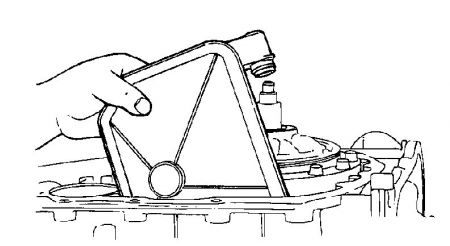

Location of the Transmission filter? I hate to admit it but I'm stumped on this one :oops:. Thanks :)

Did you drop the transmission pan? Unless I'm out to lunch on this one, Damn near all off them are right there. A hand full of imports (that's a funny term these days), are not accessible this way.

I have changed trans filters and fluids all my life but for the life of me I can't find a filter on this tranny!This is a 2003 dodge stratus coupe with a four cylinder engine.I took every pan off the transmission and I don't see a filter anywhere.Where is it ? Is it hid in there somewhere? Does it even have one?

I think this is one of those that aren't worth changing. Granted the labor time says an hour, but getting info on it is terrible. Typical of chysler products. This is the best I could find with what I have:
https://images.2carpros.com/forum/automotive_pictures/30961_transfilt_1.jpg
