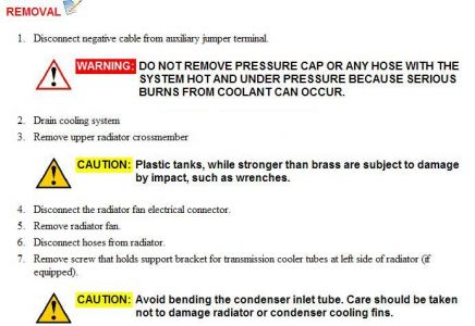

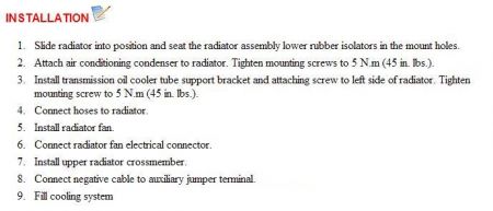

HOW DO I GET THE RADIATOR OUT TO REPLACE IT
Dec 9, 2009 at 4:06 PM
BLUELIGHTNIN6
  • 16,542 POSTS
https://images.2carpros.com/forum/automotive_pictures/261618_Noname_1248.jpg
https://images.2carpros.com/forum/automotive_pictures/261618_Noname2_367.jpg
https://images.2carpros.com/forum/automotive_pictures/261618_Noname3_140.jpg
