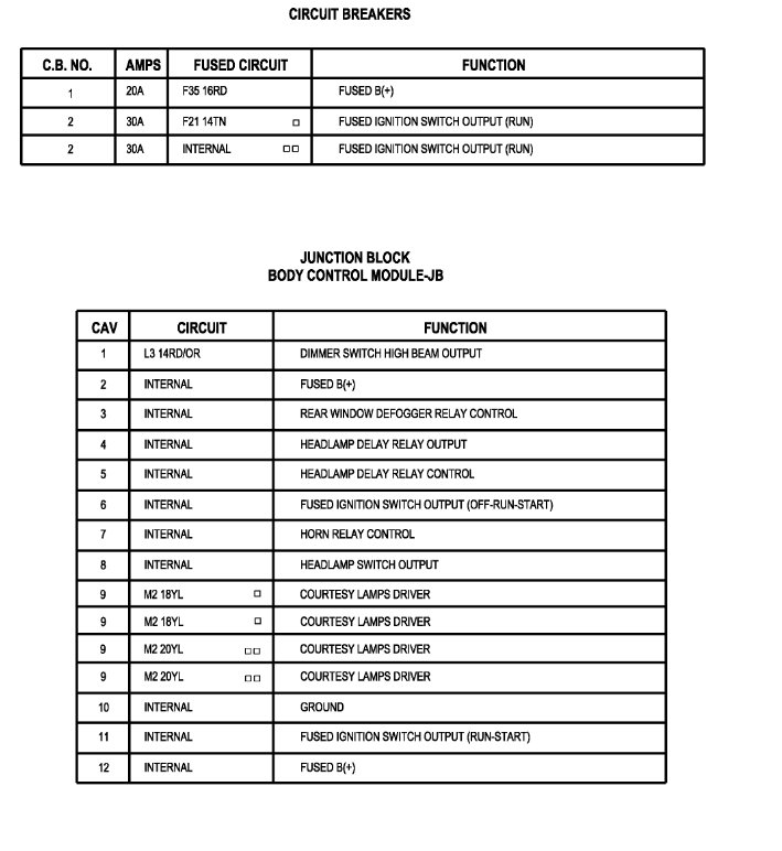

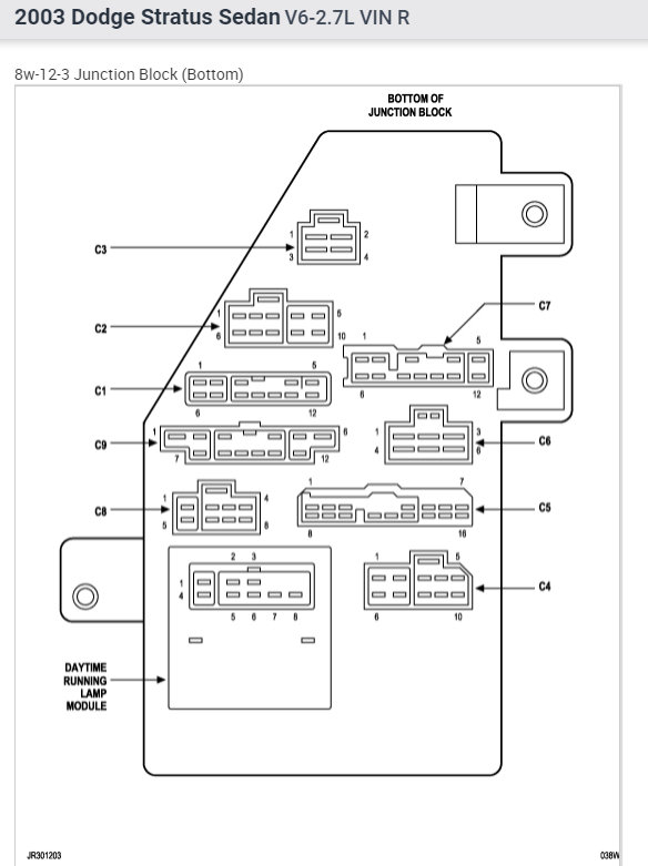

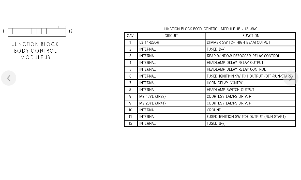

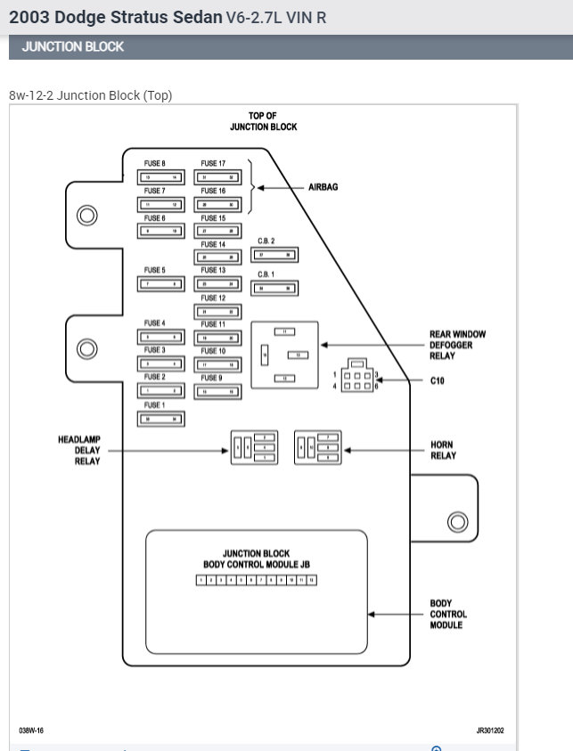

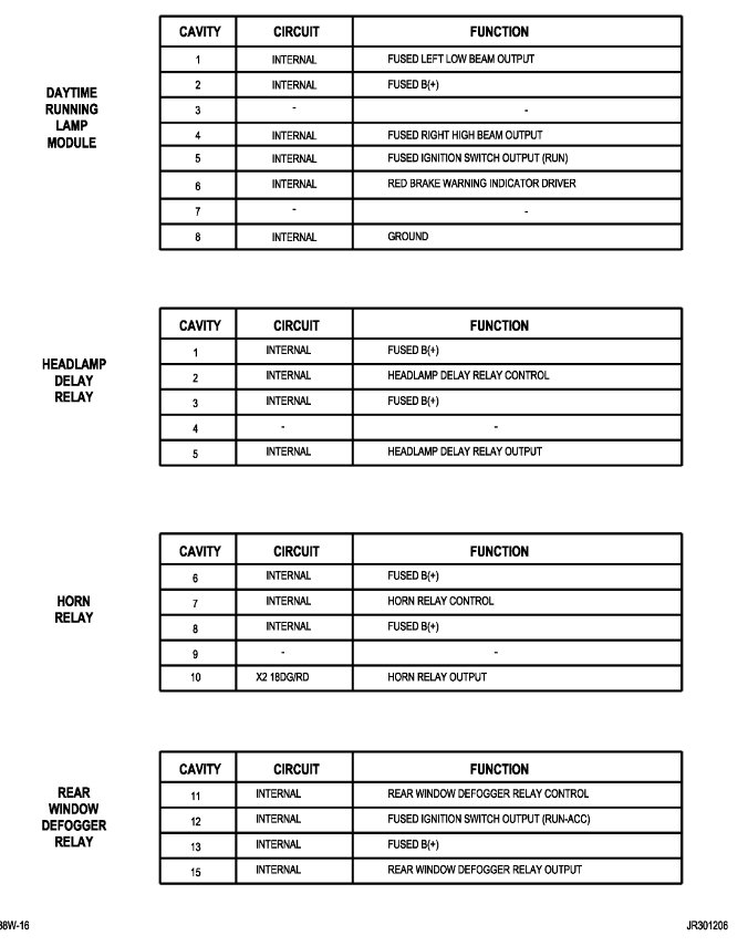

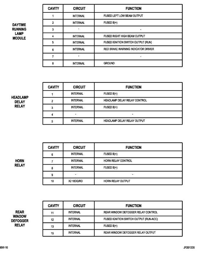

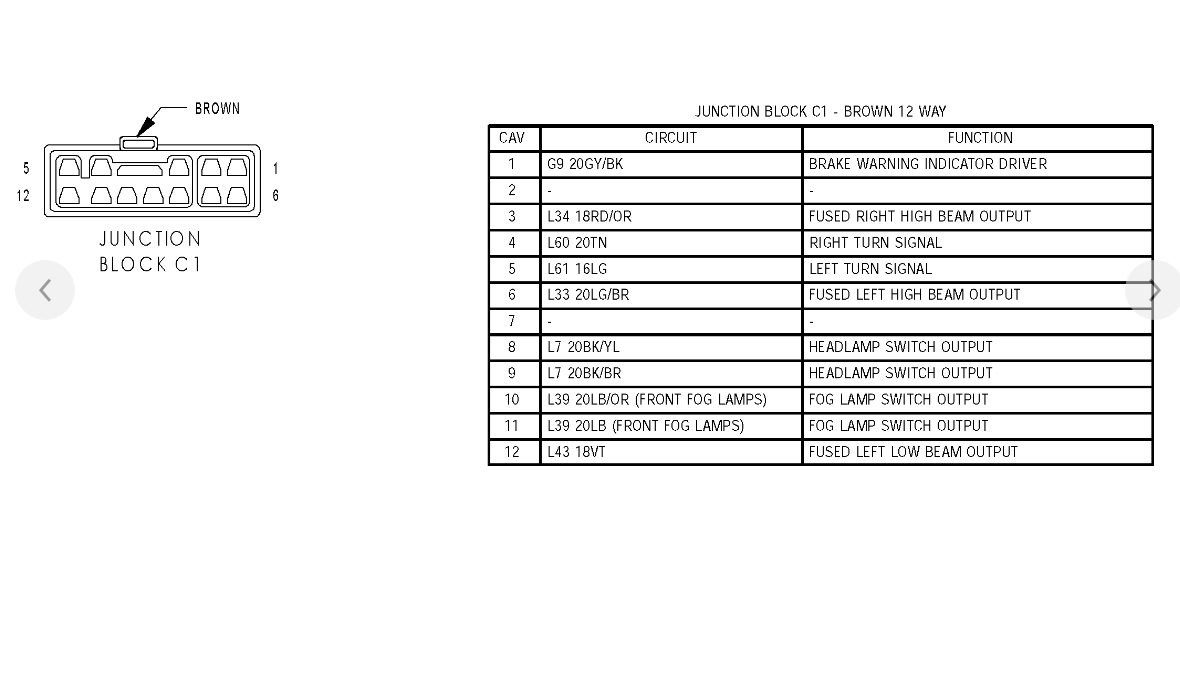

Where can I find a detailed sketch of the fuse box
2003 DODGE STRATUS
99,000 MILES • 6 CYL • FWD • AUTOMATIC
KELKEL985
Where can I find a detailed sketch of the fuse box for the air conditioner so I can troubleshoot why my Air conditioner is not coming on!!!!!
Aug 19, 2008 at 10:13 PM
SQM
  • CAR REPAIR CONTRIBUTOR
  • 6,383 POSTS
See attached diagrams for the fuse box.
