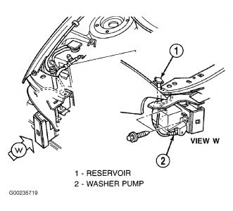

Do you have the procedures to remove and replace a windshield washer pump?

WASHER RESERVOIR PUMP
Removal
Disconnect negative battery cable.
Partially remove bumper fascia as needed to gain access to the reservoir pump.
Place a drain bucket below the reservoir to catch any washer solvent that may leak out.
Firmly grasping pump by hand twist and pull away from reservoir and out of grommet. Care must be taken not to puncture reservoir.
Remove rubber grommet from reservoir and throw away.
Installation
A new grommet is required for installation.
Firmly grasping pump by hand twist and push into reservoir. Care must be taken not to puncture reservoir.
Reinstall bumper fascia.
Refill reservoir with the washer solvent.
Connect negative battery cable.

do you have a picture of the pump installed on the bottom of the bottle?
Dec 8, 2008 at 11:14 AM
DAVE H
  • 13,384 POSTS
this is the only picture i have i'm afraid ..
