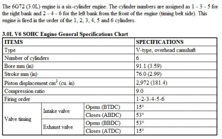

Need engine firing order for 2002 dodge stratus rt 3.0l

https://images.2carpros.com/forum/automotive_pictures/261618_Noname_2116.jpg
