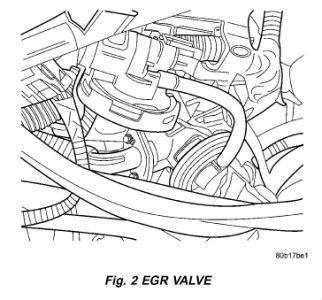

how do you replace an EGR control valve
Jul 24, 2010 at 6:08 AM
  • 75,992 POSTS
Service and Repair REMOVAL The EGR valve and Transducer are to be replaced as an assembly. Disconnect the negative battery cable. Remove the air cleaner box. Fig.2 EGR Valve
https://images.2carpros.com/forum/automotive_pictures/12900_egr_18.jpg
Remove the 2 bolts EGR tube to EGR valve. Remove the 2 bolts for EGR valve to cylinder head. Disconnect the electrical connector from transducer. Remove the vacuum hose from the EGR transducer. Remove the EGR valve and transducer as an assembly INSTALLATION Clean surfaces of cylinder head and EGR tube where EGR valve interfaces. Install new gasket between the EGR valve and the transducer to cylinder head and loose install bolts. Install the 2 bolts from EGR tube to EGR valve. Tighten the EGR valve to cylinder head bolts to 22.9 N.m (202 in. lbs.) . Tighten the EGR tube to EGR valve bolts to 11.3 N.m (100 in. lbs.) . Connect the electrical connector to EGR transducer. Connect the vacuum hose to EGR transducer. Install the air cleaner box. Connect the negative battery cable. https://www.2carpros.com/kpages/auto_repair_manuals_alldata.htm
