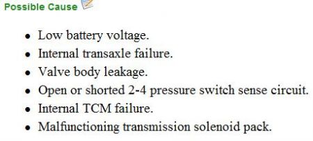

i have some codes that came up and wonder what they mean. can you help me with them. they are p-0733,p-0700,p-0731,p-0846,p-0732.

All codes are related to your transmission. P0700 Auto trans DTC exists P0731 Gear ratio error in 1st gear P0732 Gear ratio error in 2nd gear P0733 Gear ratio error in 3rd gear P0846 2-4 pressure switch sense circuit Most gear ratio errors are fixable with new input and output speed sensors. But P0846 is a lot more than that.
https://images.2carpros.com/forum/automotive_pictures/55316_02stratusp0846_1.jpg
