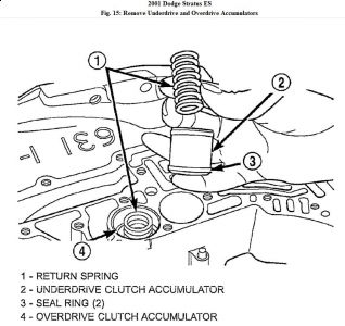

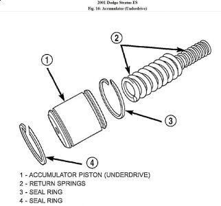

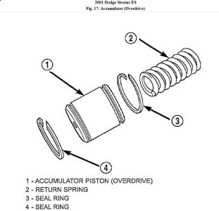

I replaced the neutral switch ,when I removed the body above filter two pistons fell down one is green the other is black, both have spring inside ,there is small spring can you tell me where they go.?and I got code P0732 Gear 2 Incorrect Ratio

Hi sergio rodriguez, Here are the diagrams for the accumulators.
https://images.2carpros.com/forum/automotive_pictures/192750_TransComp01StratusFig15_1.jpg
https://images.2carpros.com/forum/automotive_pictures/192750_TransComp01StratusFig16_1.jpg
https://images.2carpros.com/forum/automotive_pictures/192750_TransComp01StratusFig17_1.jpg
P0732 is an intermittent code and are often caused by intermittent hydraulic seal leakages in clutch and/or accumulator circuits. they should be checked only under the condition when they are set. Note : A reset counter, located on Chrysler's Diagnostic Readout Box ( DRB_III) Scan tool, indicates the number of engine starts since DTC was set. This aids in determining if thDTC is hard or intermittent code. If reset counter shows less than 3 engine starts, it is a hard code. If reset counter shows 3 or more engine starts, an intermittent code exists. Possible causes for the condition are : 1 . Low battery voltage. 2 . UD and 2-4 pressure less than 105 psi at 2000 rpm. 3 . UD pressure is less or greater than 5 psi in 4ht gear. 4 . Leaking transmission seals. Coda can also be set byy intermittent input and/or output speed sensor circuit. It is not going to be easy to diagnose this fault without the aid of appropriate diagnostic equipments.
