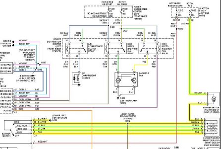

The heater blower motor not working is not working. Tested no power at switch. Checked fuses and all look fine. Is there a relay? if so what is its location?

I don't see any relay in the wiring diagram. Just two fuses at the end of the dash, Fuses #1 and 11

Believe it or not, the power to the switch comes from fuse #1 to the blower motor, to the blower resistor, and grounds at the switch. Check continuity that way.

Thank you so much for the information. Is the junction box shown in the Diagram the fuse box? or is there another junciton bax some where?

Yes, the junction block is the fuse box at the end of the driver dash.

from looking at the diagram you sent the power come into the fan motor and the switch provides the ground? I really appreciate you help!

You got it...
