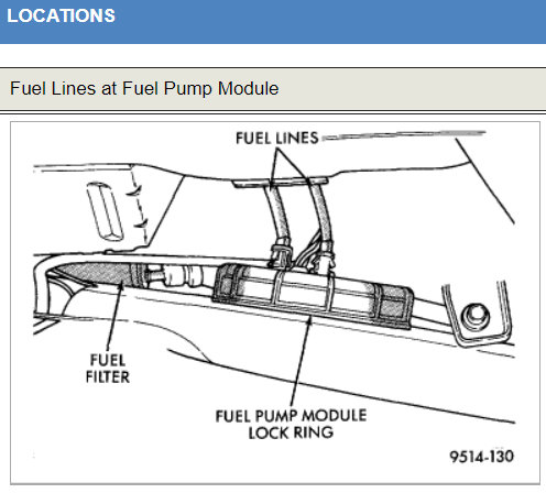

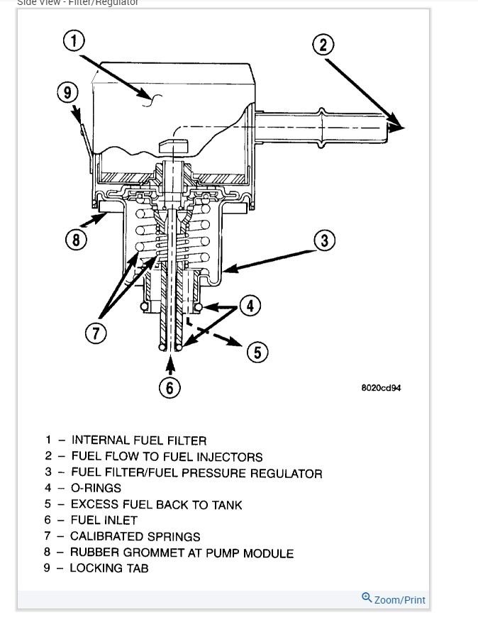

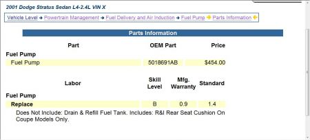

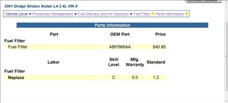

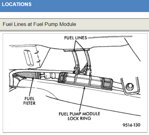

Hey guys, I have a 01 Stratus SE 2.4l DOHC and I wanted to know if the fuel filter is IN the tank or is it just by the tank and around how much does a filter cost? Thanks for your help

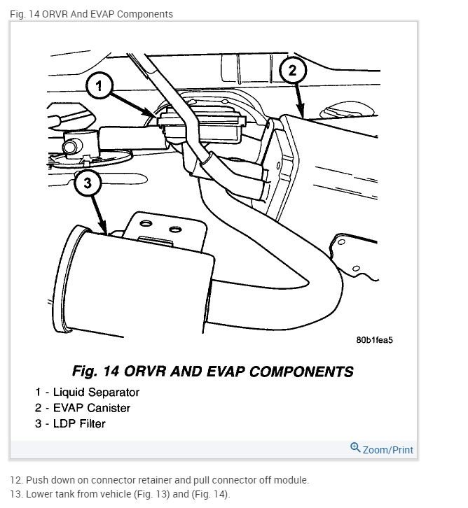

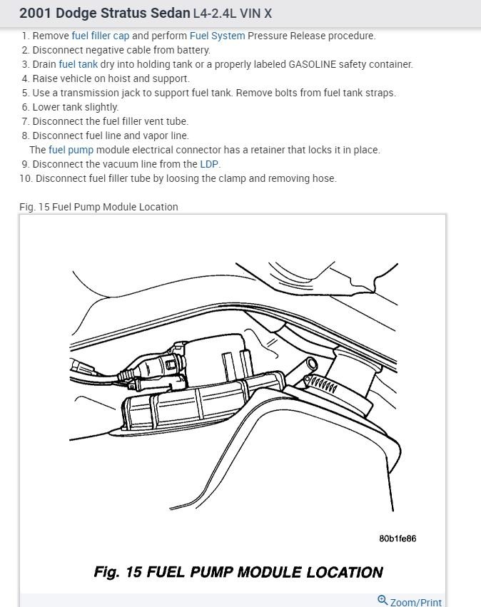

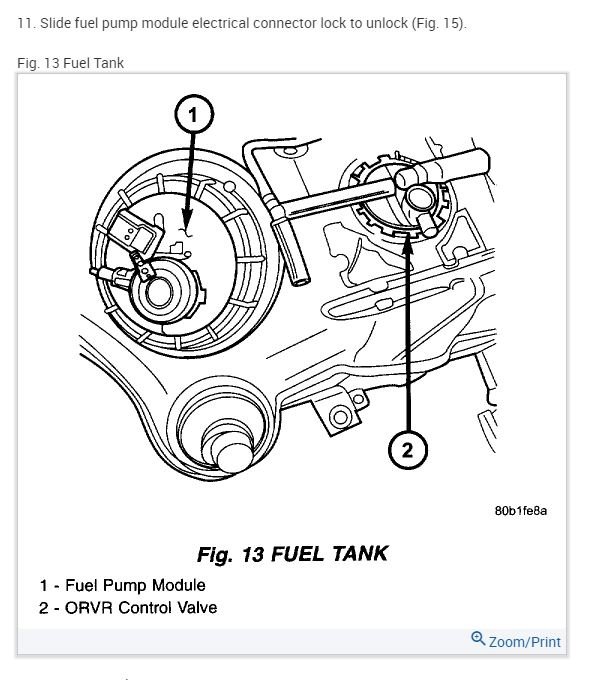

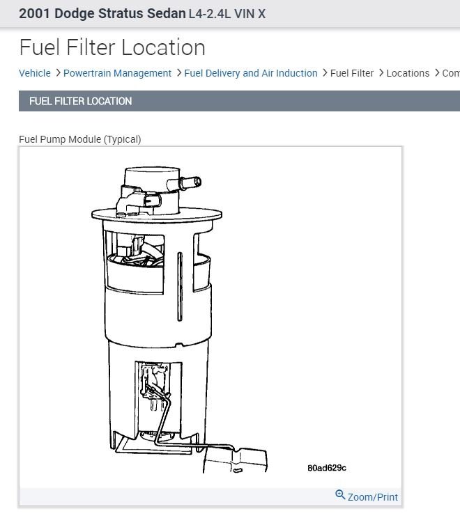

The fuel filter is part of the fuel pump module. To remove the module you must first remove the tank, here's a guide and diagrams for this procedure
https://www.2carpros.com/articles/how-to-replace-an-electric-fuel-pump

Hey rasmataz, I was told by a guy at AdvanceAuto today that they dont sell the fuel filter and that I would have to buy the fuel pump module and that is $214. I guess that new filters are in the fuel pump modules, is that right? Is there any other way of getting this done? If not I will have to get the module and about how long does it take to install the module?

Double check if its replaceable w/o the module, we talking about big time money on the module-see below
https://www.2carpros.com/forum/automotive_pictures/12900_fuel_filter_5.jpg
https://www.2carpros.com/forum/automotive_pictures/12900_fuel_filter1_1.jpg

Ok just returned from Shell station shop. The worker lifted my car we searched and searched and could not find any type of filter outside of the tank. So does that mean the filter is INSIDE the tank and how would I go about getting a filter unless its the one that the guy at Napa showed me but it has some quick disconnect hoses and some type of mounting bracket. Is the strainer the guy from Advance told me considered the fuel filter? I dont know.

You have a fuel strainer at the end of the fuel pump assembly. Replacing the strainer requires dropping the fuel tank down, removing the fuel pump assembly, prior to getting to the strainer filter. It is not advisable to perform the work without a garage, in my opinion.

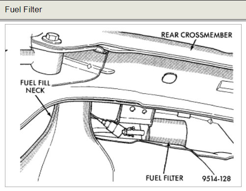

The fuel filter mounts to the frame above the rear of the fuel tank. Here is a guide to show you what yoo are in for when doing the job.
https://www.2carpros.com/articles/how-to-change-a-fuel-filter
Here are diagrams (below) showing the fuel filter location on your car

Fuel Filter
https://www.2carpros.com/forum/automotive_pictures/12900_ff_24.jpg
Fuel Pump Module/Fuel Filter
https://www.2carpros.com/forum/automotive_pictures/12900_ff1_6.gif

Fuel filter is located on the frame, above rear of fuel tank. Fuel tank must be lowered for access to fuel filter. Fuel lines are permanently attached to fuel filter.
https://www.2carpros.com/forum/automotive_pictures/261618_Noname_55.jpg
Need removal and installation instructions? Just ask and you shall receive.
