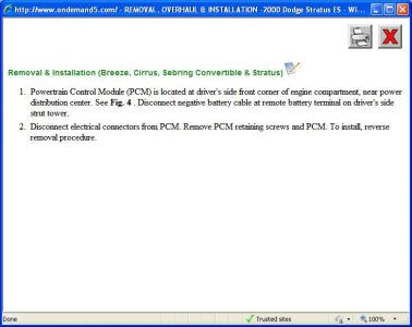

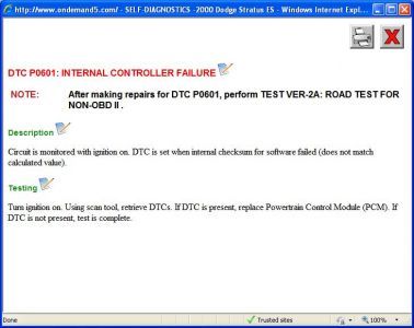

My sister's 2000 Doge Stratus is throwing a DTC (p0601) that says "Int Control Mod Memory Check Sum". I understand that this is not good news for the PCM. Are there any connections to check or tests to run before it is time to give up on the old PCM and get a new one?
Once I do decide to get a new PCM is there anything I need to know before I buy a new one or attempt to mess things up, like does it need to be programed? Is it user programmable? What makes this a difficult fix? Or it is as easy as plug and play?

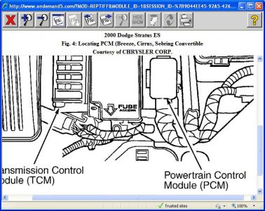

First of all thank you so much for your donation.It say's if you have that code bad pcm it's a internal failure.I posted the code description how to change it where it is.They have to be programed unless you can find one that is already programed.What model stratus and engine size do you have?
