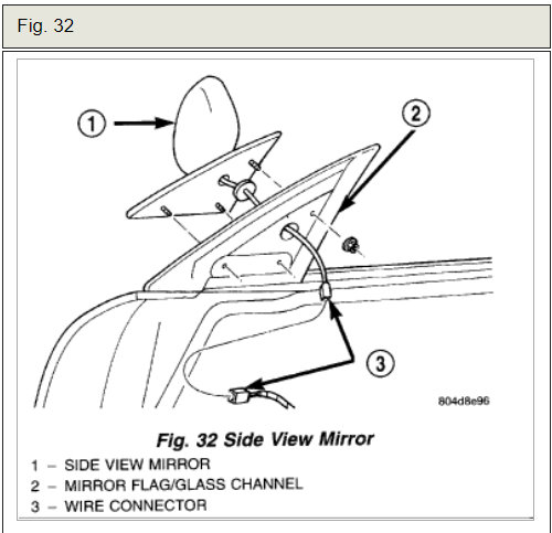

How can I re-attach my passenger side mirror? Some awful nice person decided it was in their way and kicked it off the car. It is hanging on by the electric mirror control cord.
Thanks

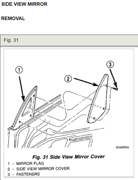

You will need to remove the door panel here is a guide to help you see what you are in for when doing the job.
https://www.2carpros.com/articles/door-panel-removal
Cheers
