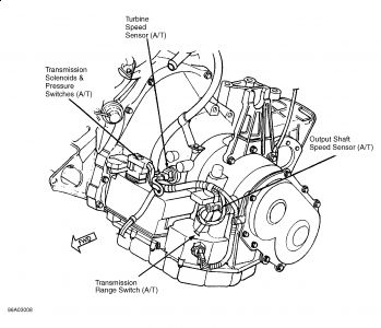

my car speed odometer is not working and it wont come out of first gear..the check engine light is on and it read change output speed sensor...i need to know where to locate it on the transmission

Left side trans
https://images.2carpros.com/forum/automotive_pictures/198357_Grafic_3_46.jpg
